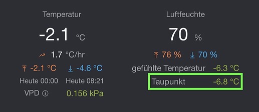

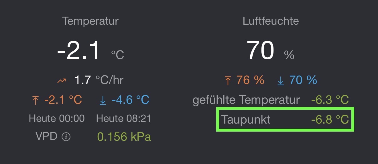

Indeed, the dew point is calculated incorrectly in the Homey Misol and Ecowitt app, well spotted, @qawsedrf57! :+1:
Dew point acc. the Homey Misol and Ecowitt app: -2.1 °C
Dew point acc. the Ecowitt iOS smartphone app: -6.8 °C

Yesterday, I connected my WS90 to Home Assistant for testing purposes, and it displays the same dew point as the Ecowitt smartphone app.
So the conclusion is, that the calculation of the dew point seems to be wrong in the Homey Misol and Ecowitt app.

Basically, I can confirm that:
WittBoy GUI
Homey Insights
The 0.1 °C difference may be due to the fact that insights in Homey are smoothed out for display durations of more than one hour.
