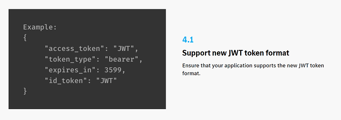

Have been browsing my fork, and I think we need help from your end to fix this. A few urls need to be updated inside the app
I have published a new test version. Can you let me know if there are still any issues.
Thanks for the heads up on those changes, that saved me a lot of time searching the documents.
Still issues. Sent you logfile
Could you make sure the tokens are up to date in the Configure app page and then restart the app to see if that helps?
Tried making a new id on test version, missing token error in log but app gives no errors. Still will not update car info.
Yes, refreshed secret again, and inserted. restartet app 1.0.0. Still the same issue unfortunately.
Did you also update these URLs ?
