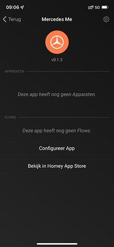

Can you confirm that the app has updated to 0.1.7 or 0.1.8?
No i cannot, i cant find that version, where can i update it?

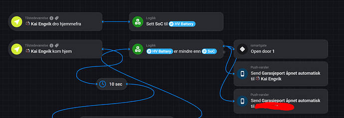

Is it possible to make signal if the ignition is on or something? wnat to find a way to make a flow that can register when the car arrives home, and open the garage door. I.e. when “person” came home, and ignition is on, then open garage door. something like that.

Hi again. I have found different uses for this app now. One of the most useful is the one to open garage door when the car gets home.

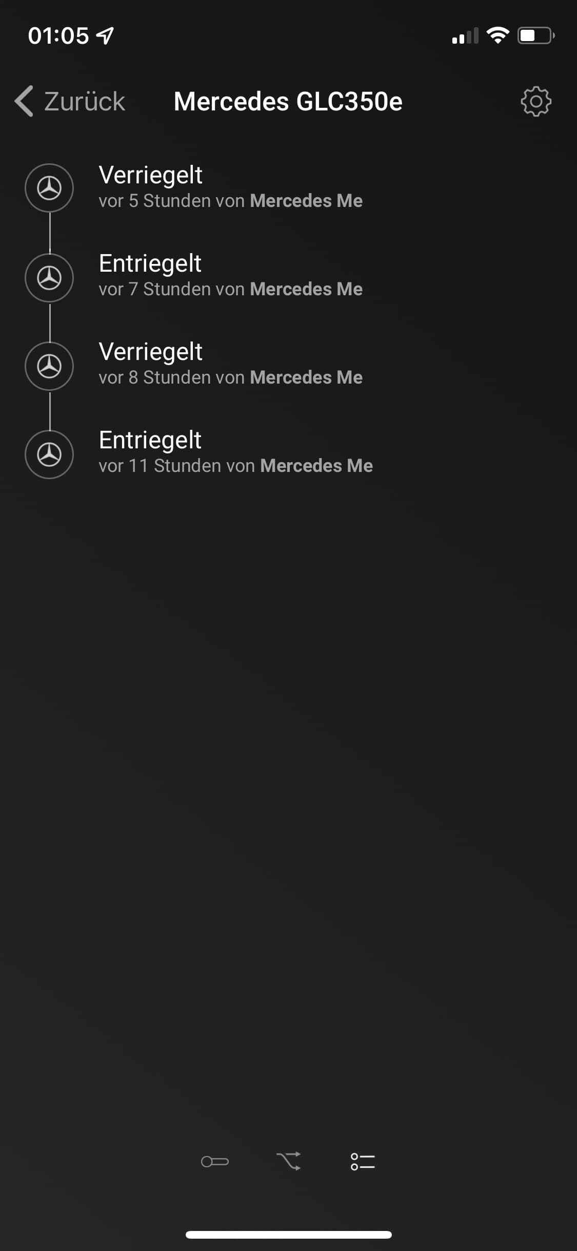

@Adrian_Rockall sorry to bother you I’ve read that you sold your mercedes. However may be you can help my anyway. I’ve added the car and I do see in the homey timeline that my car eg. was locked/unlocked, so it seems to work somehow. However under the device I see the message “Coud not get OAuth2Client” → Repair. I’ve done the “Repair” multiple times and I was driving in the meantime, so the car was pinged for sure. Do you have any idea? I just sent you via homey the app log…

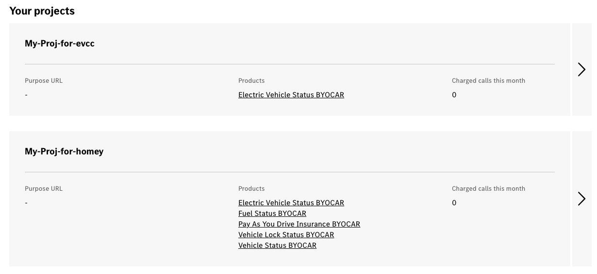

Hm very strange then. I’ve created exactly because of the polling limits a second app in the mercedes dev portal:

Ok, I deleted the Homey App and created an additional app on the mercedes dev portal. Then downloaded again your app on homey where I’ve added the information from the new mercedes dev app → on homey I got the mercedes callback where I could grant access to my car, but then only “token refresh issue”. I’ve restarted the homey app but no change, so I decided to switch back to the credentials of my first created dev mercedes app - and tada, I got some message about the wrong token, but after a homey app restart it works now…
