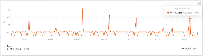

@m.plo.b, can you please share with me CPU usage of your Homey and the MELCloud Homey app in particular around:
  • August 26 2:30 AM (+/- 5 minutes)
  • August 27 2:30 AM (+/- 5 minutes)
  • August 29 3:00 AM (+/- 5 minutes)
Also, what let you deduce the values stop updating, have you any screenshot to share? Would be very helpful.
I assume your time values are maybe UTC, because 2 hours later (UTC+02:00 here) I have indeed CPU peaks:
