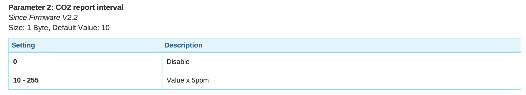

Although I already noticed it only updates when CO2 changes >50ppm which seems kinda of rough to me
That seems to be a setting according to the manual (p4)
Should I be able to adjust this here?
I tried using “1,1,5” (parameter,size,value) but that does not make a difference (I don’t understand the explanation above the parametersection (“IMPORTANT: controllers may …”)
As mentioned in the linked manual, 50 ppm is the smallest reporting interval:
10 (Value) x 5 ppm = 50 ppm
Btw, your Z-Wave raw configuration parameter are wrong. ID 1 is the ID for parameter 1 = CO2 threshold value
For parameter 2 CO2 report interval it should be like this: 2,1,5
But as already mentioned 2,1,10 (50 ppm) is the smallest reporting interval.
