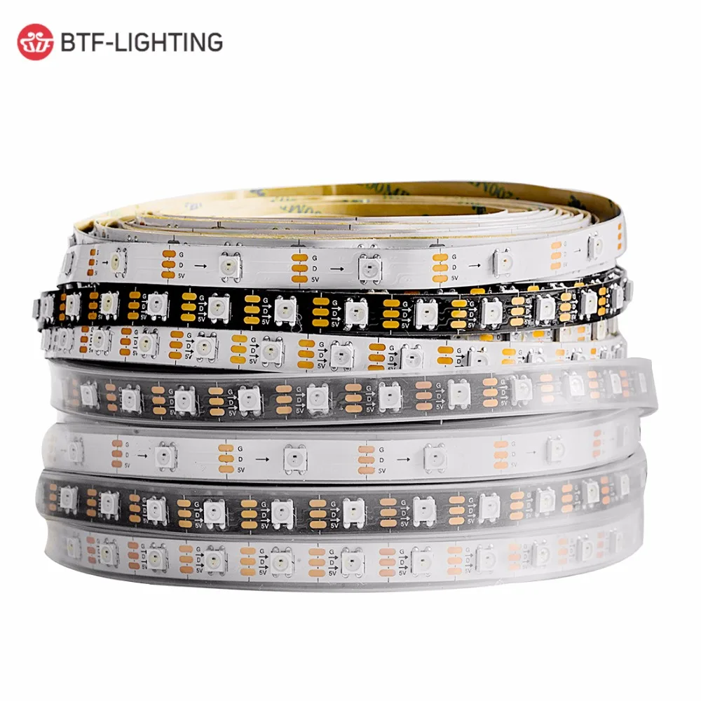

Could you point me to a aliexpress link that has a controller and led strip that works with your app and has individual addressable led’s ?
I am getting confused with all these names and worried i will order and wait for weekd for the wrong thing.
LED strip: https://www.aliexpress.com/item/32995602877.html?spm=a2g0s.9042311.0.0.72034c4dHCaq7K
Controller: https://www.aliexpress.com/item/1005001408152784.html?spm=a2g0o.productlist.0.0.2c2a3a12ZTdQv5&algo_pvid=41b14f77-7146-4f5d-913d-5ee03a7b70d9&algo_expid=41b14f77-7146-4f5d-913d-5ee03a7b70d9-4&btsid=0b0a01f816036463474714820e93a9&ws_ab_test=searchweb0_0,searchweb201602_,searchweb201603_
You need the 5V version which is sold out at this seller. But you should be able to find it elsewhere.

Can you help me with pointing out a 5V power adapter which delivers enough amps if I want this strip with 30 Leds a meter for 3 meters?
I thought I would need 3 meters x 9 Watts a meter = 27. Then 27 : 5V = 6A. But I am not sure
9watts per meter for a strip with 30 LEDs per meter seems rather high. Are you sure about this?
To be on the safe side this is the formula I use.
((meters * Watts p.m.) * 1.1) / Volt = Ampere
I know, but if I click on
The link for the ledstrip you pointed out, it says in the specs that 30 Leds use 9W a meter:
Maybe I should ask the seller about this.
So I got an answer from the seller. Hey confirms that 30 Leds on 1 meter needs 2 Amps, so 3 meter needs roughly 6 Amps.
What do you think about this. Seems a lot to me.
“Each individual NeoPixel draws up to 60 milliamps at maximum brightness white (red + green + blue)” (source). With 30 leds per meter, you’ll need to provide 30 * 0.060 = 1.8A, so 2A is close enough.
However, it seems that may be based on old(er) information. I just tested with a NeoPixel strip that has 41 LED’s, and it’s taking about 0.5A at full brightness white, so 12mA per LED.
That was a nice piece to read. Thank you for that. So basically it means that 6A for 3 meters is only necassary when I intend to use all Leds at full brightness.
