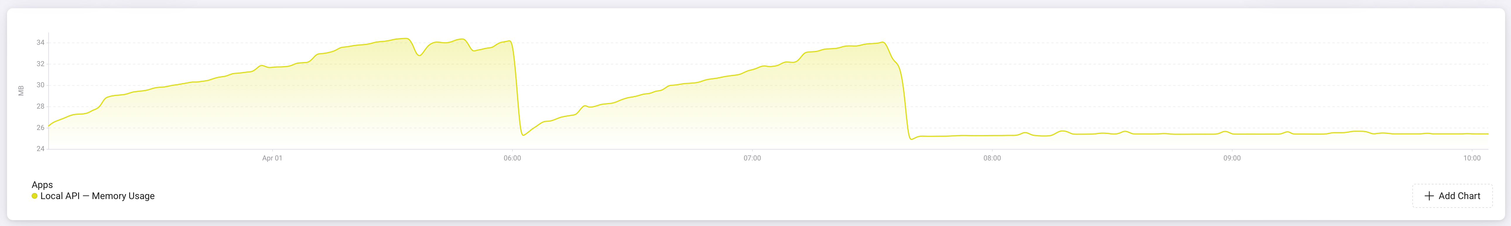

I’d say the memory issue looks to be fixed. Exact same call being made once per 60s throughout this graph; no prizes for guessing when I installed the test version (also disabled my flow that rebooted the app every 2 hours when I installed the test version).
Next I will go back to more frequent refreshes and see how it copes.
It’s very likely that passing around req and res caused memory leaks, and now that this has changed by only passing the required data it also solved the memory leak.

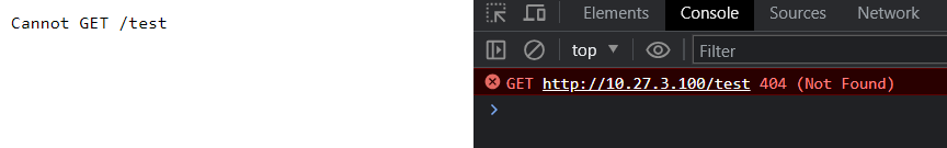

I have a principal error with http://Homey-IP:80/test
Get 404 Error code: Cannot GET /test
Please can you help me?
V1.1.5
HP2023
OK, now I am using Port 8080 instead of 80 and it works

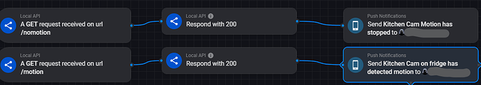

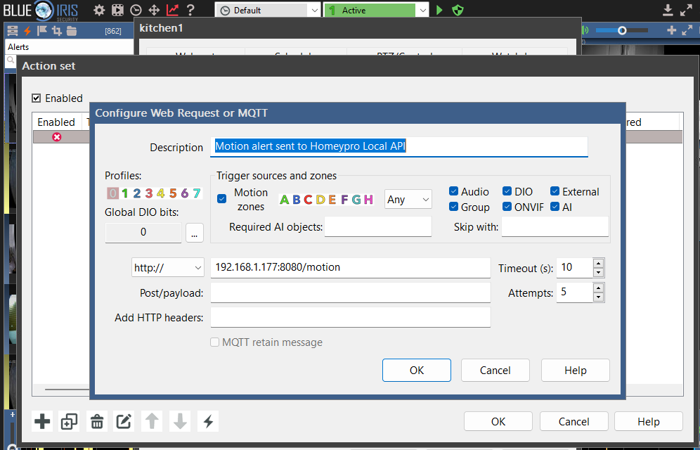

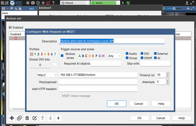

Hello
I just wanted to thank you for this post… i had the same problem trying to setup Blueiris to trigger a flow and changing my port from 3000 to 8080 Worked!
