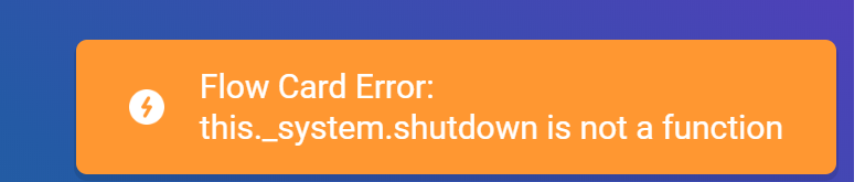

Great app, thanks! Most of my Kodi flows are working, but I have problems with the shutdown/hibernate triggers.
When I try to shutdown Kodi using flows I get the message:
It would be great if the shutdown functionality is working, instead of turn off the power outlet (for sd corruption).
I’ve tried it on a Raspberry Pi 3 B+ with OSMC and Libreelec. Both distro’s has the same issue. Anyone have a idea to fix this?
Using a workaround at the moment with a JSONRPC command:
{“jsonrpc”:“2.0”,“method”:“System.Shutdown”,“id”:1}
Working correctly!
Hm this error should have been solved in a recent update. Which version of the Homey app are you using? And which version of Kodi are you running?

Can you please send me a log after you have encountered the error in your screenshot?
