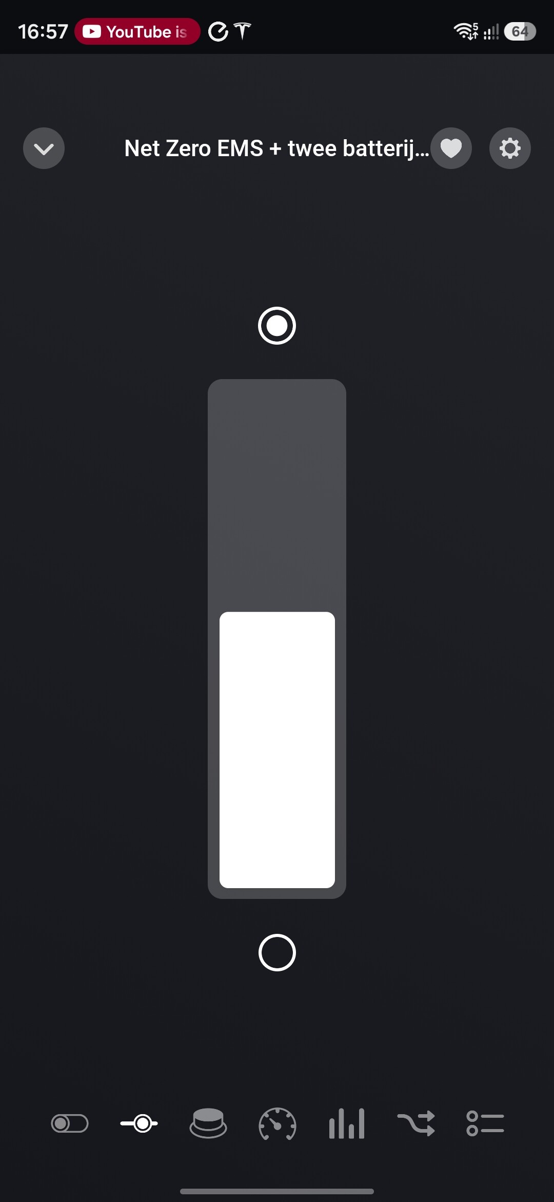

This one, battery backup min

I’ve got this. It shows 3000%?
yeah that is it, since its the only one in that strategy homey doesnt show the name, but it indeed is that slider. Move it to 1000% :wink:
Yes the formatting is not nicely devided by 100%. Ill see if I can fix that without breaking anything :wink:
Thank you for clarifying will test this tonight :wink:
Set it to 500% still not under 30% :frowning:
Bug lcoated thanks to your diagnostic report. Indeed changing te slider did not trigger updating my memory cache, a patch is now on test that solves this. Changing any setting would update the memory object with your selected slider value.
