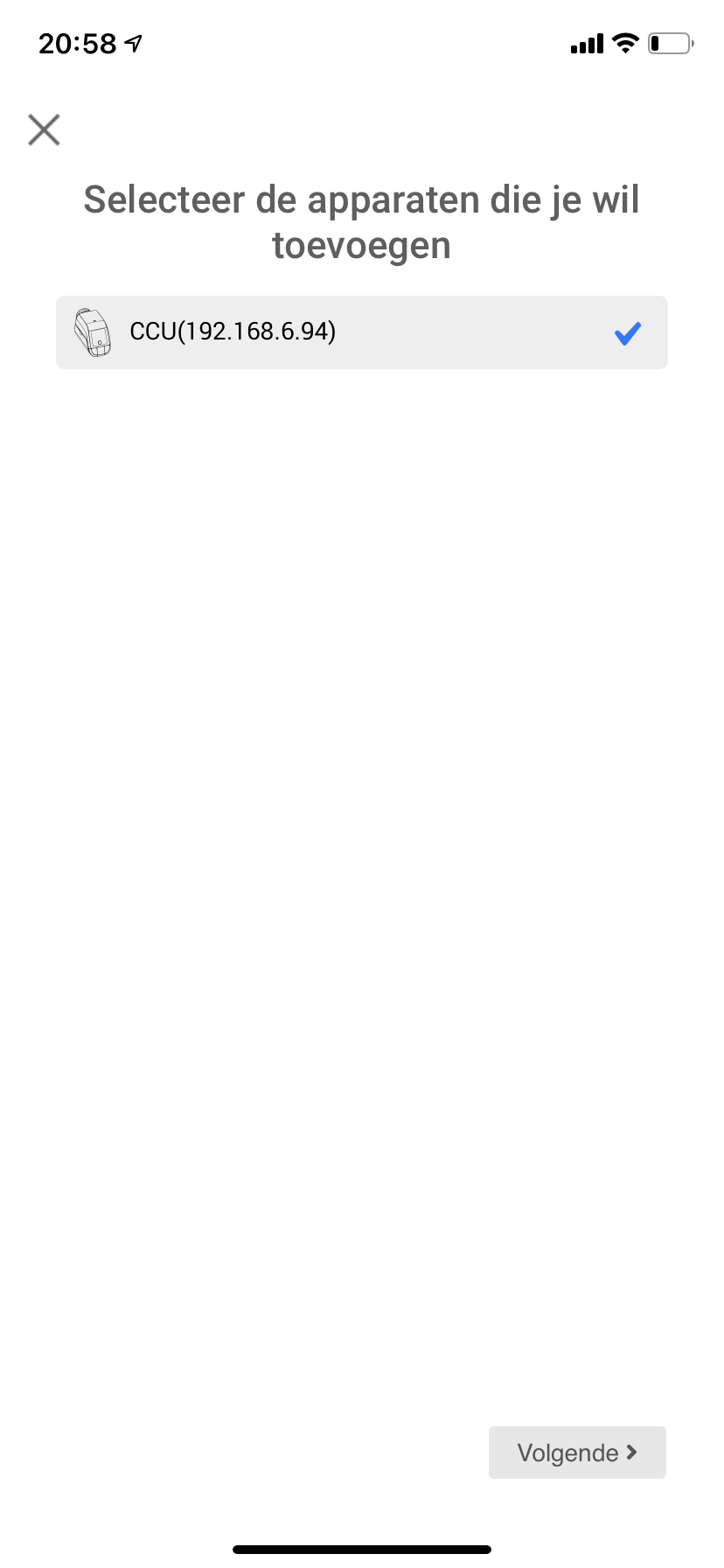

now when i try to add devices i get this the ip address of the ccu

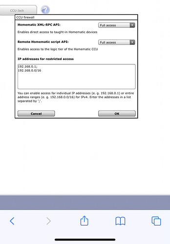

It seems like everything is configured correctly (because you are able to add devices), but anyway here are some info about the configuration of the CCU and the Homey Homematic App.

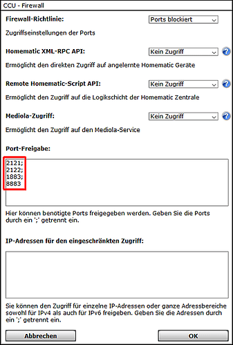

Info from the CCU installation description on GitHub
In the firewall of the CCU, ports 2121 (HTTP), 2122 (HTTPS), 1883 (MQTT) and 8883 (Secure MQTT) must be unblocked, depending on the use case:

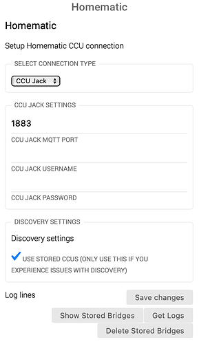

These are the settings of the Homey Homematic App I have (I guess port 2121 in you setting will also work):
→ Save changes
→ Show Stored Bridges (then you will see a serial no. and the IP address of the CCU)
Yes, this is correct. So you can add your device.

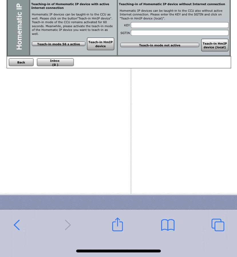

can’t add devices can’t find them not in inbox

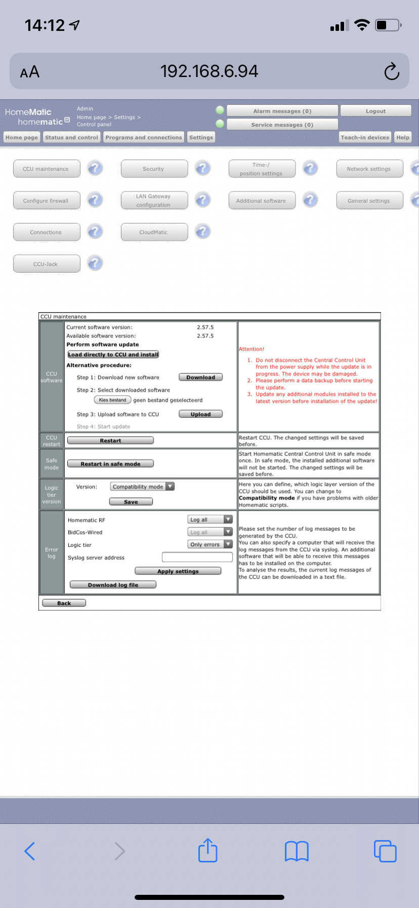

t the firmware is up to date of not?
And we see only this not the options the you have
No, what I found in the internet the current FW for the CCU2 seems to be v2.57.5 (Link).
After a firmware update the layout may look different.
But sorry, I can’t do all the internet searching for you.
yes sorry but I doubted because thought if that install then the jack-ccu disappears hence the question and maybe a bit stupid I just came too
mail sent to homematic why I can’t add the devices
The screenshot shows that your current firmware is version 1.1.1.1 (which is really strange!).
It may be that the firmware version 1.1.1.1 doesn’t support the HmIP-WTH-B devices, because the fw is old and the devices are more or less new.
So the first way would be to update the firmware. If it is possible to update the firmware directly from version 1.1.1.1 to version 2.57.5, I don’t know.
I have updated the software to the newest I confused it with additional software because I think it is good but I still do not get more options with the firmware in principle it is not necessary I think because homey sees it but I still have to get it done to connect devices to ccu2 according to homematic who just answered I have to reset everything to factory and should work I am very curious
