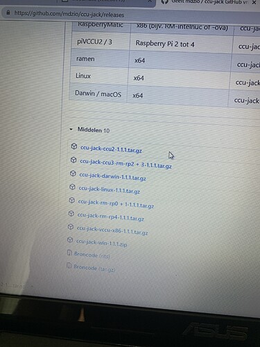

thank you for your quick responses I will first buy a ccu2 found it on market place 1 and then we will try to get it right so that I can connect it to homey because that is the greatest wish
Yes, the ccu-jack-ccu2…. file.

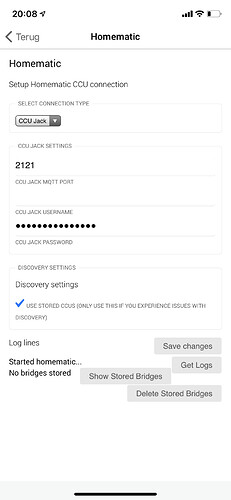

Thank you I have installed it can I then teach devices after that in homey the devices
or do I need to do more before that?
First you have to pair the devices with the CCU2.
Then you have to config the connection between the CCU2 and Homey in the Homey Homematic App. After a successful connection process you can add the Homematic devices with Homey, if they are supported by the app.
Actually I‘m not at home, so I can’t have a look into the settings of the CCU, so it could be that there have to make some settings to. Tomorrow I will habe a look into and let you know.
BTW, there is no need to do some settings in the CCU-Jack interface.
There is no PW needed.
