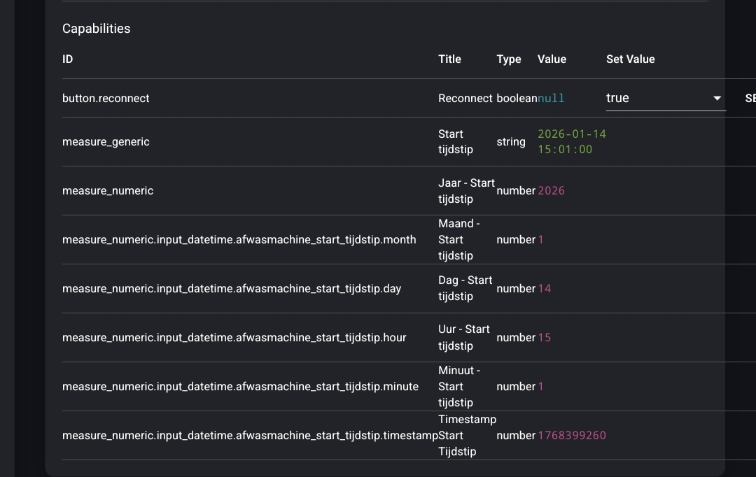

This is a text capability. Only boolean capabilities will show up in the log (if log is enabled in capability definition).
If you need a log, then you have to add the entity again using a boolean capability (alarm*) and add a converter that returns true or false based on your possible entity states.
Thnx, that worked. Things getting clearer now.

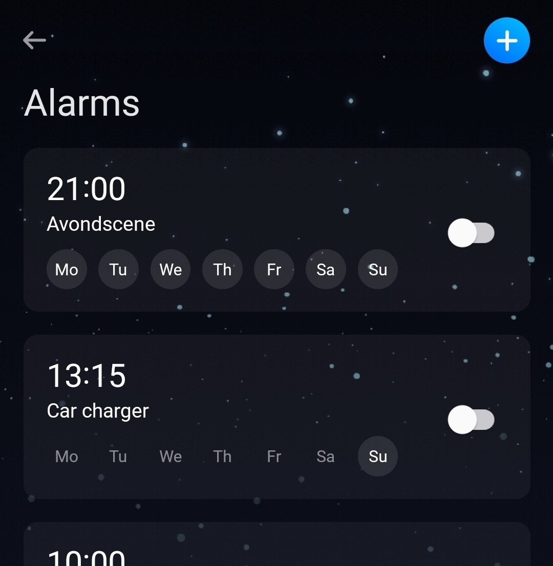

This is a longshot, because Homey Alarms, these things
are not devices with capabilities:
Is it possible to somehow sync an input_datetime helper with a Homey Alarm?
I mean, it’s not a problem to send the input_datetime values to a custom device, but the other way round, to pick a timestamp/alarm on Homey, which updates the H.A. input_datetime, isn’t possible (yet).
