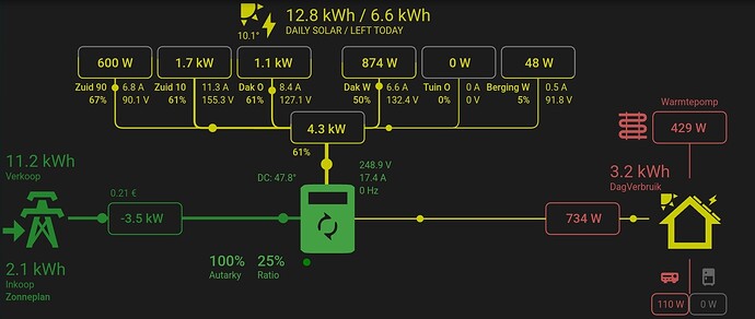

I just found the Sunsynk power & energy flow card I’d like to share with you.
I’ve 3 PV inverters with 6 strings, which can be showed nicely.
Sunny:
Night:
It also has battery & EV options

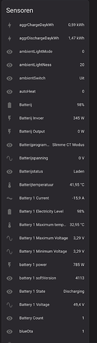

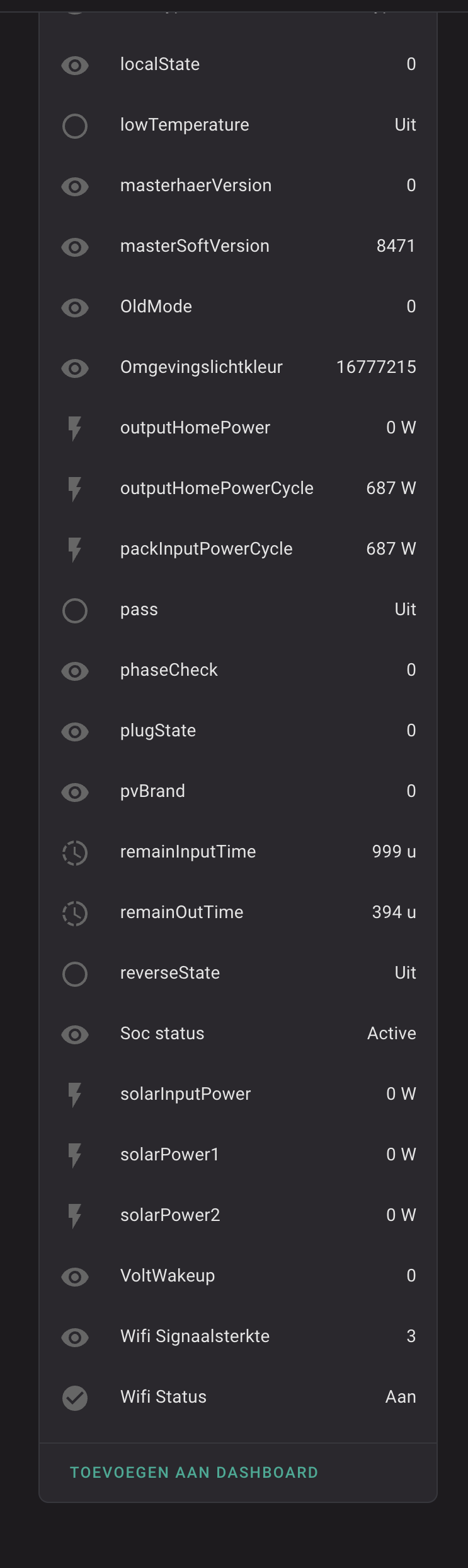

Hi all,
I’m trying to add my three batteries and have entities for input power, output and percentage batterij set voor a device. But Homey says it’s inactive in Homey Energy. I guess I should do something else. Who can help me?
Besides power values, you’ll need the energy values as well
Could you tell me which one maybe? I added EnergyPower but still it’s inactive.
Most probably the top two entities (kWh), Martijn. You have to use specific Homey capabilities for those.
Details in Ronny’s blog:
Thanks. But thats the issue; I don’t have one capability for input and output. Those are two. So, Homey sees only charging and not discharging, depending on which one I make the main capability.
I fixed it. For anyone with the same issue; add a sensor template with negative value for the output in HA. Combine input and output in a group. Use the group as the entity in Homey.
Nice idea using the group :+1:
