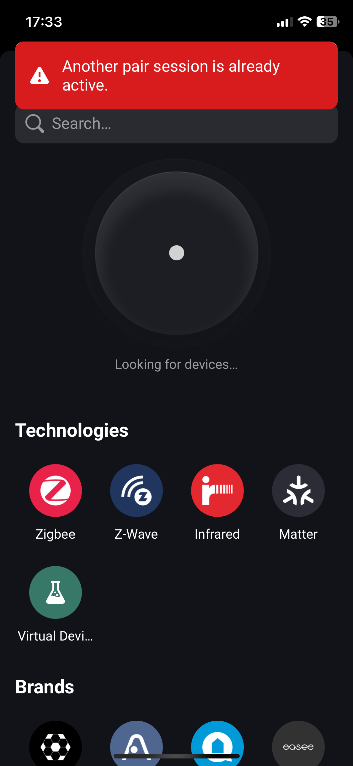

I have multiple Heatit Z-dim2 installed. Did some configuring on one of them, and it seem to be stuck between added and not added. I removed it from devices, but I could not see a confirmation that it was removed. However, the device was removed from the overview. When trying to add it back to Homey, it does not respond to the “push reset button three times” command. No light in the status light of the dimer, whatsoever. I found an “uknown” node (number 8) in the Z wave settings in developer.homey, and managed to remove it. But now number 8 is nowhere to be found, it skips from 7 to 9.
Anyone know what to do do get this included again? I have turned on and off the fuse to reset it that way, but that did not do the trick.
Trying to add the device as an Z wave device rather than through the Heatit controls app gives me this error, so I guess there is a bug….
Anyone know what to do?
Some more info. The dimmer works outside Homey. It dims the connected light, but Homey won’t connect it.

This is a normal behavior within the Z-Wave overview. If a device has been removed, the NodeID is (usually) not used a second time. With the Homey Pro (early 2016-2019) it was always the case, with the Homey Pro (early 2023) I noticed myself that an “old” NodeID was reused. However, it may also have something to do with the fact that I migrated the Z-Wave devices from HP19 to HP23.
If you run into problems with inclusion again, restart the device app. If this doesn’t help, restart Homey. And if that doesn’t help either, do a PTP.
Please always wait a certain amount of time between the inclusion of new devices and the above steps before continuing.
The physical function of the dimmer has nothing to do with the Z-Wave problems. Of course, it could have been that the dimmer is generally broken.

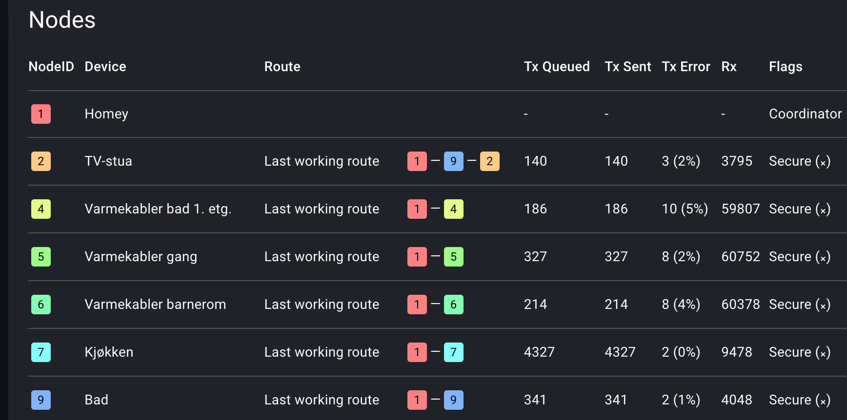

Z-temp2 devices suddenly deactivates themselves. Sometimes everything works just fine for 3 weeks and then it happens with one or more devices. Yesterday 3(!) devices was deactivated the same time, please have a look at these three screenshots from Homey (look at the “Thermostat mode ‘Off’ activated”). No one was home at that time and everything else in my Homey system worked just fine, nothing else going on.
Any idea what’s going on? Could it be related to bad z-wave reception and the devices just deactivates themselves? From the last screenshot you can see that some devices are reported as “unreachable” even though they seems to work just fine (I restarted my Homey an hour ago, thats why Tx/Rx values are so low).

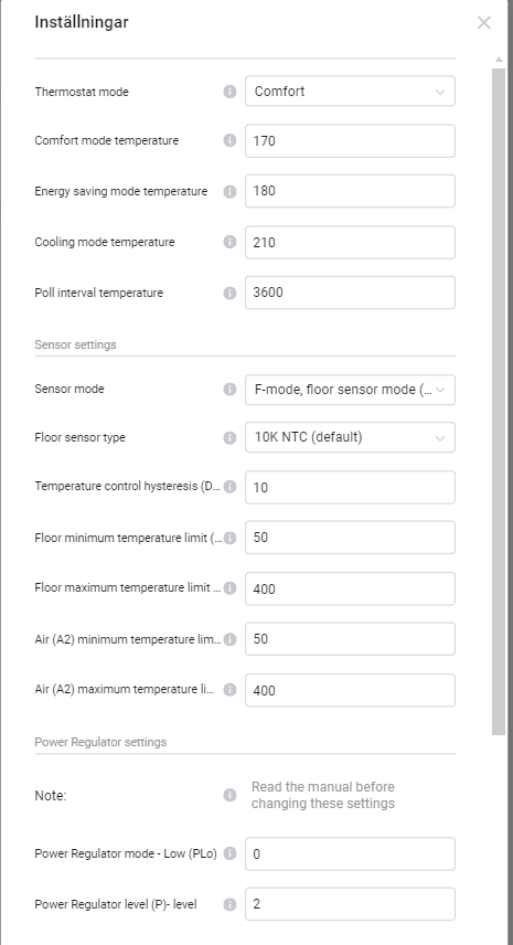

About the problem 2: Is the Inverted mode even exposed as a parameter in the app? I cannot find it?
