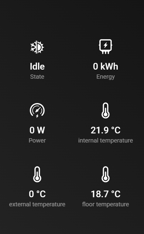

V3.9.3 breaks all zm thermostats
And all trm6 Are still going to default room sensor when app restarts .

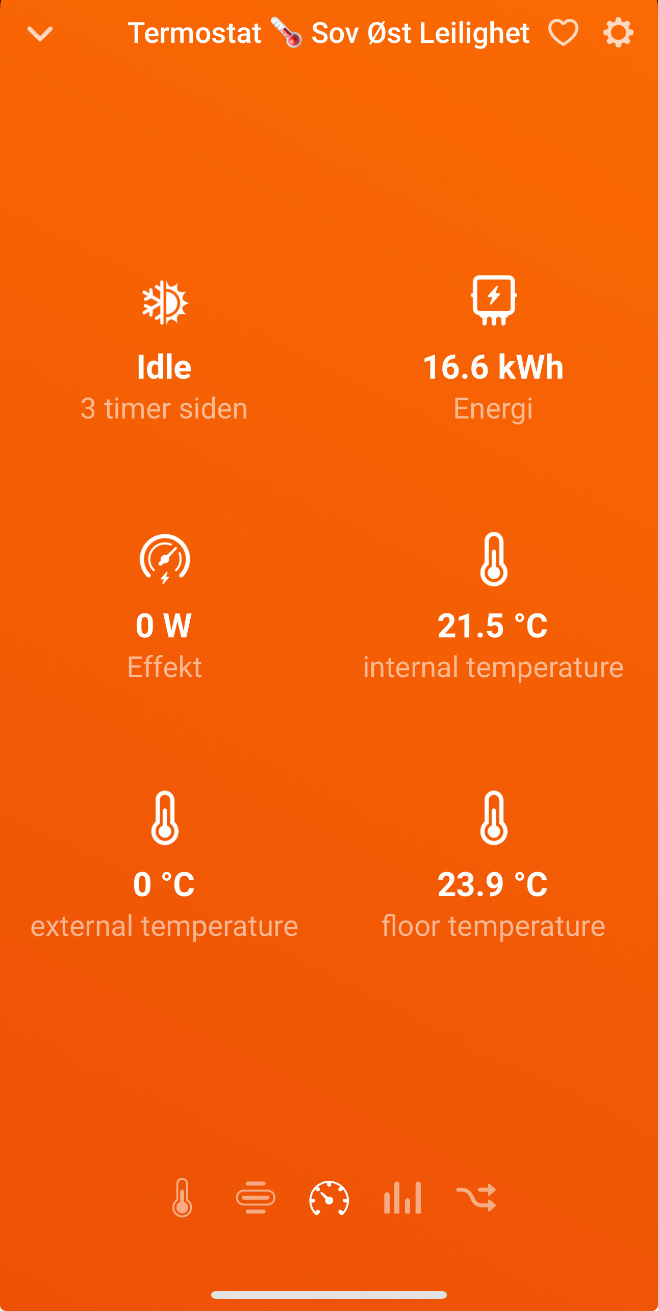

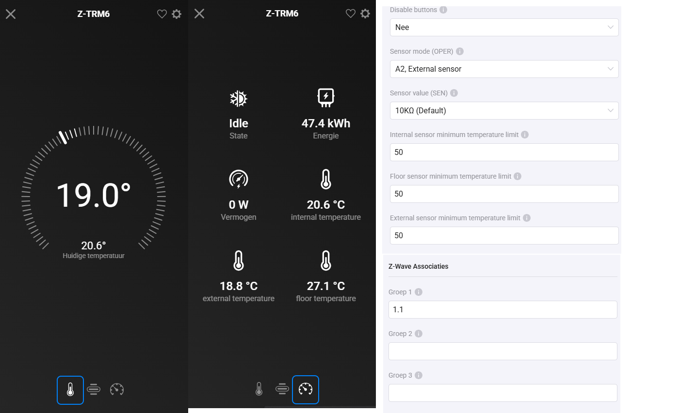

@HeatitControlsAB Can you please fix so that the correct sensor is shown? It is still going to default internal sensor, and even if we choose floor sensor, it will not show on the first page. Super annoying!
@HeatitControlsAB , I am facing the same issues as K.Olsen, where the internal temperature is shown in the current temperature overview with the set temperature above. It should show the (in my case) External sensor temperature. Please let me know what I can do to support on this to get it fixed.
