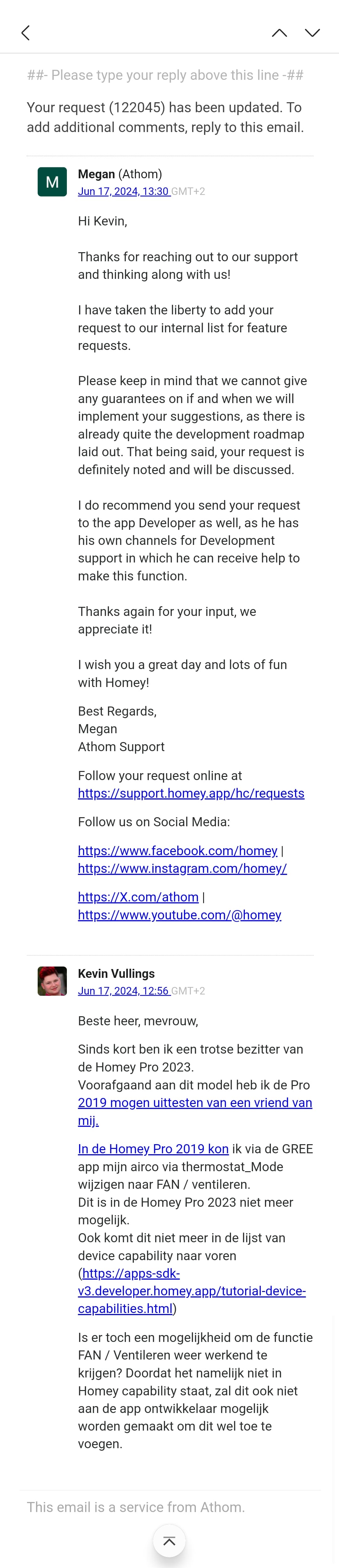

New to Homey
I connected all my air-conditions to Homey through the Gree app (they support the “Ewpe Smart” app)
While in the Ewpe smart app i can control the fan speed (see attached screenshot)
In Homey I can’t find how to control the fan speed, i can control the swing but not the level of the fan
Can this be done or added to Homey somehow ?
I wonder if you can add the “silent” fan mode for the Gree heating Pump?
“Quite” mode is already added to test version
