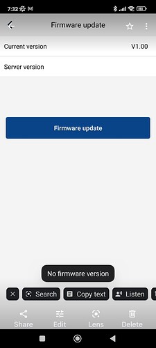

I have Gree GEH18AA-K6DNA1F/O
GEH18AA-K6DNA1F/I
And it’s terrible how its works. Also modulation it’s 750w newer coming down.
But sometimes it’s wrong because I didn’t never get update?? How its that possible…
Am getting notifications no firmware version??
Can someone tell me what happens?
