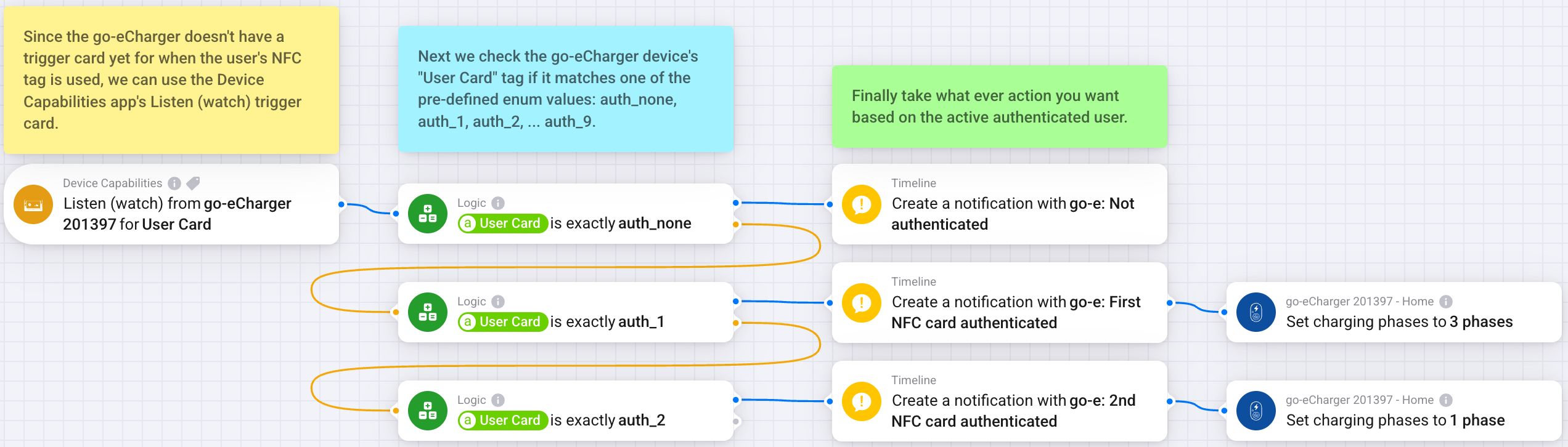

Hi! i have two EV’s. Leaf and Polestar. I need to change phases and amperes for the night depending witch car is connected. I tried Homey Polestar app but it´s no good for this. Could this be solved with RFID- tags? I tried but I couldn’t figure out how.
There is a User Card capability tag available for go-e Chargers using v2 API. However there are no events yet for it (no triggers). You could use Device Capabilities app to monitor the change of that capability.
This worked perfectly for me! Thanks!

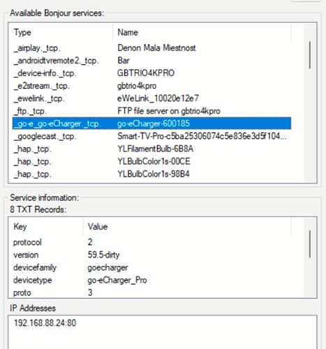

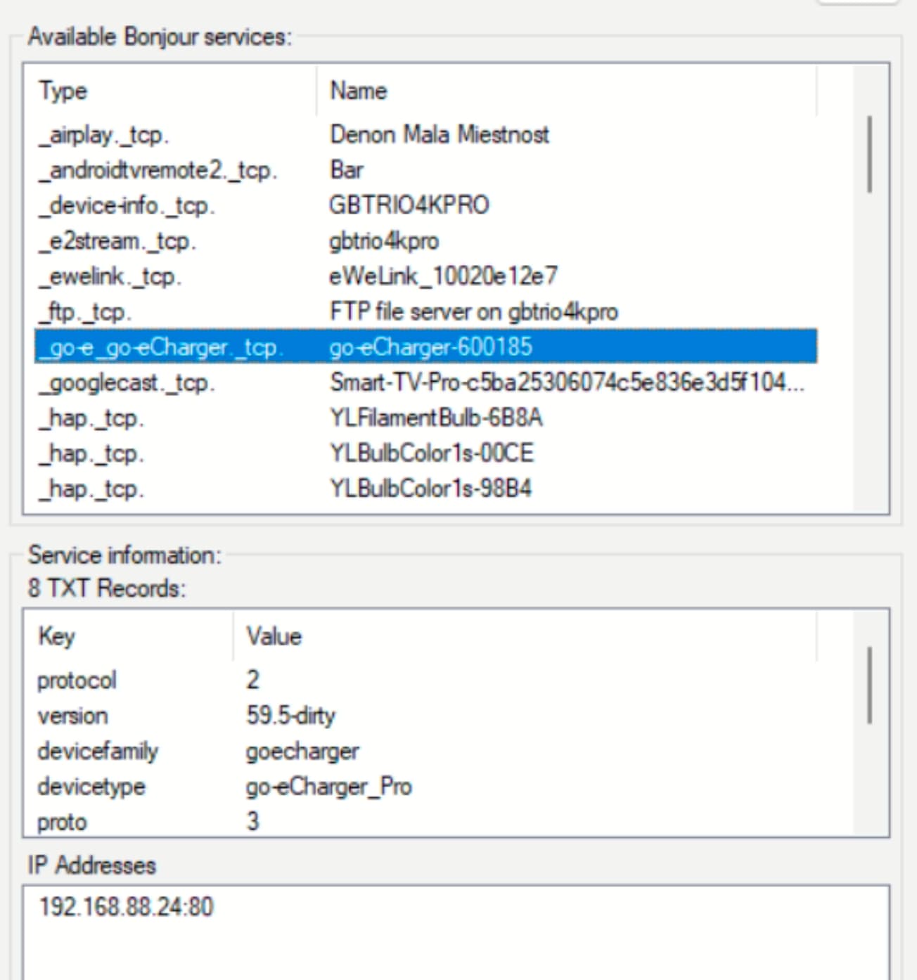

Additionally, if you could check how it advertises itself in the network:
It could be that it is not recognized as it is a new model.
here is diagnostic report id = bd7f7dd1-4f60-43bc-b123-593fc15fbbad
and here is screenshot from bonjour discovery
Thank you, that will help me to introduce the model specific driver. But it won’t fix your problem.

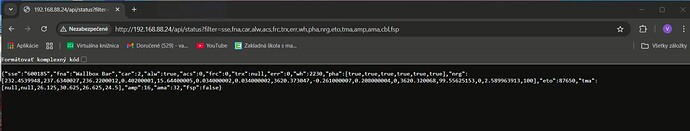

based on the diagnostics report, the app is connecting to the go-e charger, but gets a “bad request” response from it.

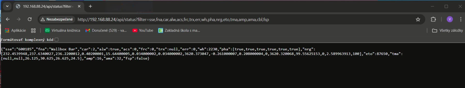

Please try this and replace the IP-ADDR of your go-e Charger
http://IP-ADDR/api/status?filter=sse,fna,car,alw,acs,frc,trx,err,wh,pha,nrg,eto,tma,amp,ama,cbl,fsp
That should return a JSON formatted response. If not, then the API is not activated properly with the go-e mobile app.
Hello, here is result. It seems that it’s working
Hmm, this is becoming interesting. I will need to contact go-e to get some information on why the new Core/Pro models rejects the request when called from the app, but not from a browser.
