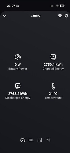

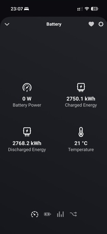

Working for me now thanks for this exactly what I was looking for
