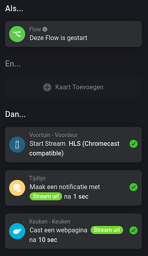

Did you use the HLS card? And a stream webpage with Chromecast?
I copied your example flow.
i needed to delay the cast flow card with a few seconds, i guess it can take a few seconds for the stream to start.
I got the same problem.

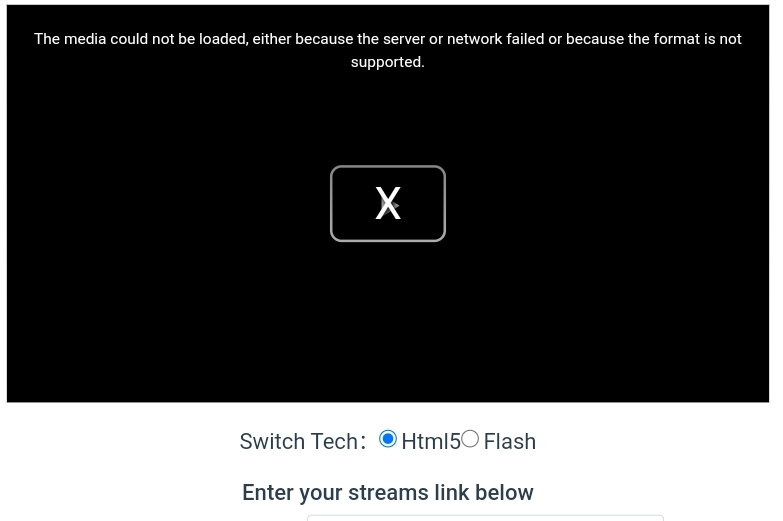

If you want to check if your HLS URL is working you can put IT in in this site: vue-videojs-demo
Oh yeah, this site is working with the link!
But not on the nest hub, streamed as an video.

Same issue, also with the rotating homey logo. Loaded as an webpage. Video is not working.

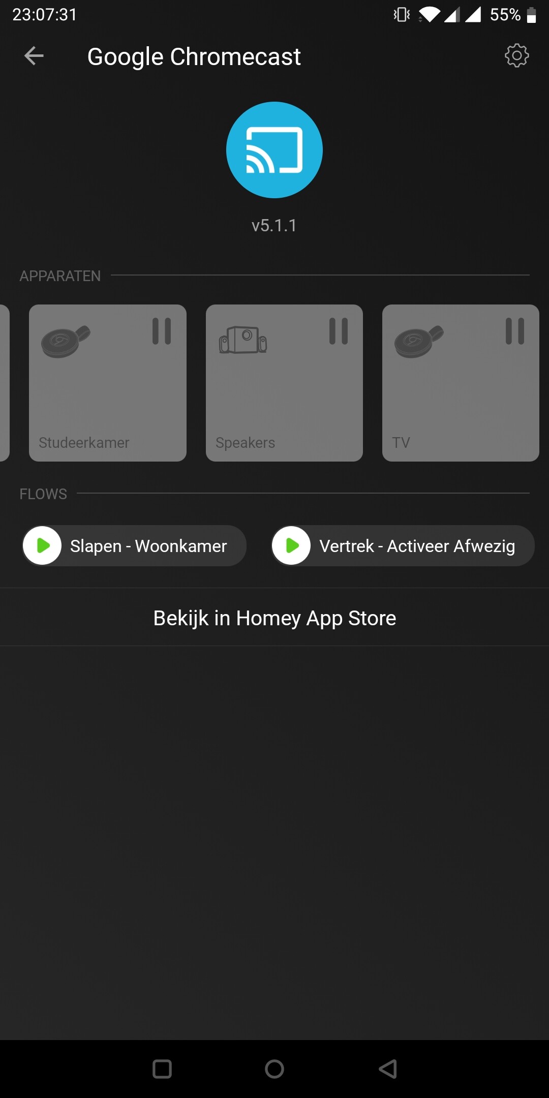

BTW: Im running version 5.1.1 of Google Chromecast Homey app
Cool, thank you Martijn!
I use the same version
