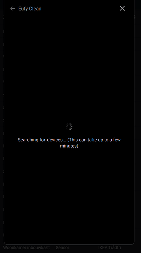

I have the Eufy L60 SES, but i cant get it to connect to homey.
If i add it with the Homey Dashboard and the Eufy Clean app keeps saying this after i logged in with my Eufy account:
After 15 minutes i closed the window.
Does anyone know if i maybe do something wrong?
Remco.
@Rembo038 please retry and send a diagnostic report.
@martijnpoppen how do i make a diagnostic report? I don’t get an error that i can report, it just keeps on loading.
@Rembo038 in the mobile homey app - more - apps - eufy clean - settings wheel right top - send diagnostic report
