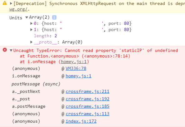

This is the result i keep getting. this test was with the Espeasy within the same subnet as another Espeasy i first tried.
That is some weird behaviour. Maybe something crashes on the Homey, although I’m not getting any crash reports. Can you try again and send me a Diagnostics report from the app settings page? I don’t get that many so you don’t really need to send me the report id if it’s a bother.
Hello, i did not see your latest message. it stays the same, Initiator is now VM20:1 but the error is the same; Cannot read property ‘staticIP’ of undefined at Function. (:78:14) at i.onMessage (homey.js:1).
i send a diagnostic report (0023a9ef-1ec8-4607-82a2-fff24c58e38b) through the app right away. sorry for the delay
I see that your Homey correctly receives messages for you watermeter from a unit called ‘undefined’ on ip …201.170 and Homey tries to reach a unit on …121.143 but that times out.

i do have a password on the espeasy so will see to remove that again. it looks like anonymous is the key word perhaps (VM193:78 Uncaught TypeError: Cannot read property ‘staticIP’ of undefined).

The ‘anonymous’ you see in the error message is just some JavaScript internal mechanic, nothing about this actual problem. You won’t find the answer there.
Homey tries to access http://192.168.201.170/json and fails on processing the result. As I don’t put the result in the log, I don’t know exactly what’s failing. Could you send me the contents of that page in a private message?
And could you also send me the expanded objects in the “units” array from your screenshot? I’m curious what the content is.
