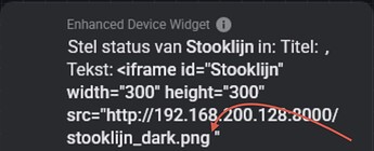

What does work (even after I stripped al the useless ChatGPT junk) is :
<iframe id="Stooklijn" width="300" height="350" src="http://192.168.200.128:8000/imagefile.png " style="position:absolute; inset:0; border:0;"></iframe>

I noticed that there is a trailing space in the image name. Could that be the reason you could not get the image displayed in the table (without iframe) in your prior attempt?
Hmm, that was sloppy…

Guess what, this works….
So even though I call the image on Homey through a ‘external’ URL, it doesn’t work…
So much for hosting image on your own Homey..
