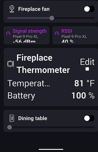

I’m using the Homey app on Android on a Pixel 9 Pro XL. The text size of an enhanced widget is just a bit too big in general
Adjusting the phone font size fixes that, but then the rest of the phone text is too small. It would be great if the widgets had a property for font-size, or perhaps font-size-adjust-percent.
You can see font-size is a generic issue - the sensors widget cuts off the value - I have a question into Athom about that.

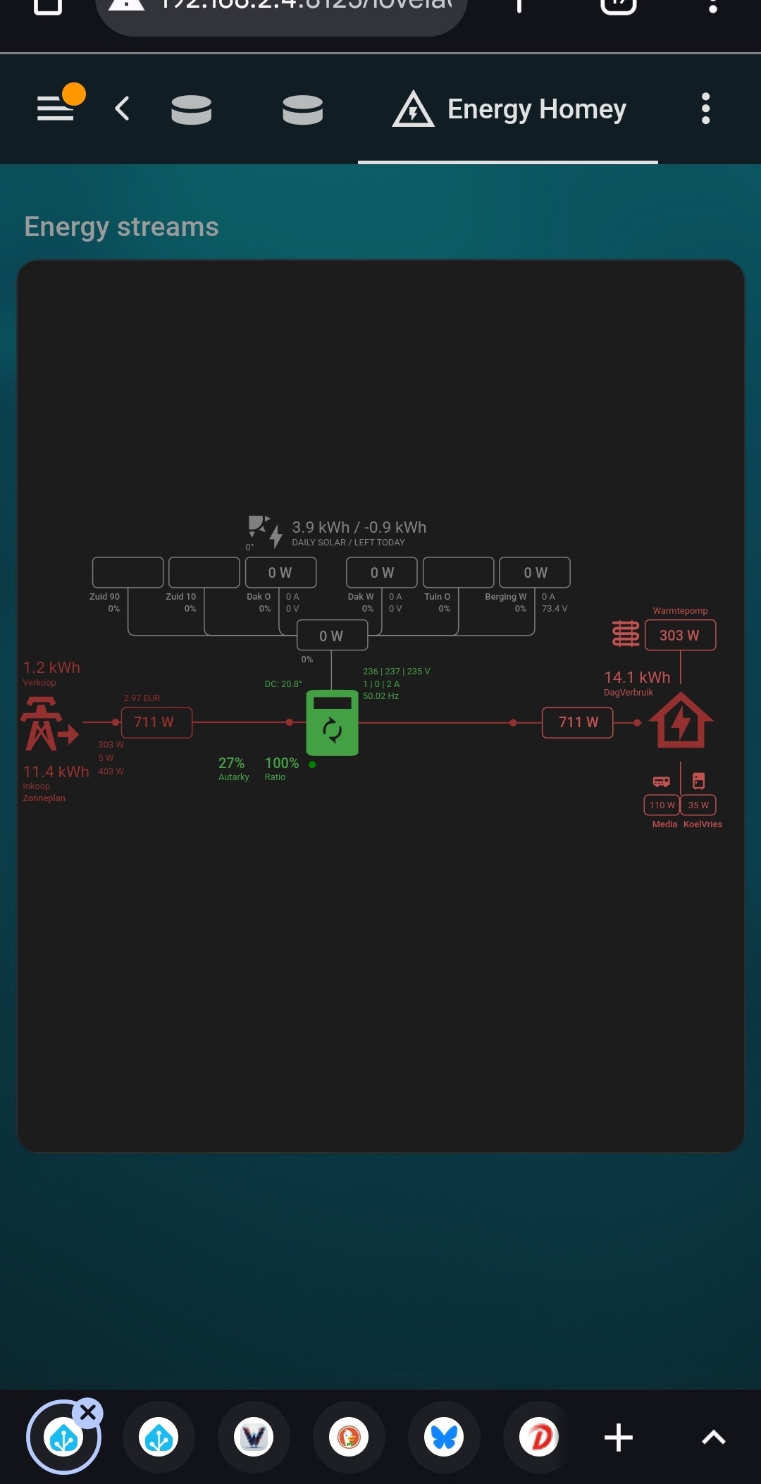

Wow. How can we combine HA and Homey in one dashboard? This is the best of both worlds!
Yeah, you can add HA components using the web frame widget.

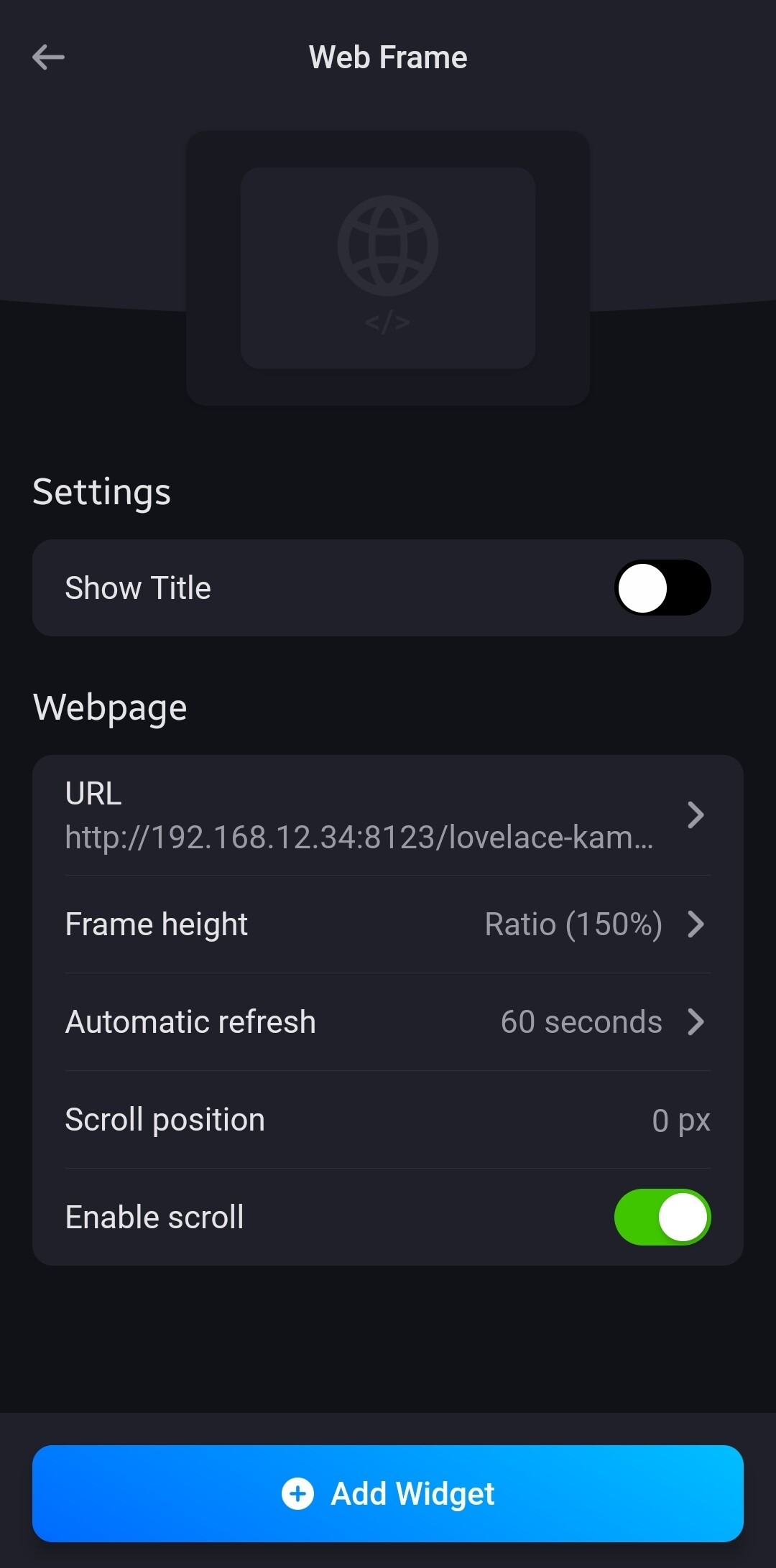

In short:
I create a separate 1 column dashboard for the components I like to add to Homey dash;
The URL of that dashboard is entered in the web frame widget.
H.A.
Create separate dashboard,
set max columns to 1
copy the URL
Homey web frame widget:
→ add ?kiosk=1 to the HA dashboard URL , in order to remove the toolbars, like:
http://192.168.12.34:8123/lovelace-kamer/energy-homey?kiosk=1
Fiddle with the ratio and scroll settings to get it to fit
Result, HAmey dash:
Multiple scrollable items
When adding multiple items to the H.A. dash, but you don’t want a loooong Homey dash widget box, you can scroll it up/down in the Homey dash.
