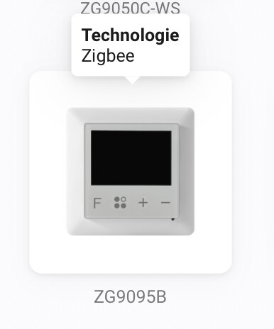

This is a Sunricher Zigbee thermostat that I would like to control with Homey Pro. Is it possible for somebody to create an app for it? Specs can be found at: https://www.sunricher.com/media/resources/manual/SR-ZG9095B-0-10V%20instruction.pdf
It should already supported in the Homey EasyLighting app:
If you still encounter problems with it, please contact the app developer in the following thread:
