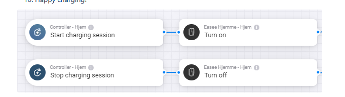

ECC will execute the when card when neccesary. That the whole point. ECC does not need to know what charger you have, it will start at 05 and stop at 06 in the case shown below
Now it makes total sense! Thanks!
Way simpler than I thought. Then basically creating a flow so that the controller gets info on the cars battery charge level on a fixed interval, I think I saw a flow like that in the documentation right?
good.
You will connect this flow
to execute when the SoC is changed. But you don’t have to, if not you must change the SoC manually in the device using the slider.
So if you are able to get the current SoC from your car, then you will call the ‘Update current State of Charge SoC card, only when a new value is received. If the the new SoC is not changed from the ECC value, nothing will happen.

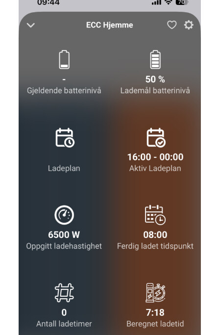

I have a simular problem. I get the charging plan populated but the when card “Start charging session” is never executed. I don’t understand why. When the planned start is reached a new plan is created and the charge session is nor started. I tried to work with different “Charger status” with no luck. Great if you have a tip! Let me know if you need any more information. I don’t have a charger I try to get this to work with just a wall plug. Thanks @bwa for a great app! I would love to get it to work, it is what I has been searching for.
send a diag, and I will check
Sent diag file as PM

I did test it now using this
dropdown was updated
and after a restart of app, the dropdown was still 08.00
Did not test reboot, as if dont want it at present time
Is there any other usecase you are using ?
All values are capabilities so they should be persisted
I do set some initial values, but only onAdded
