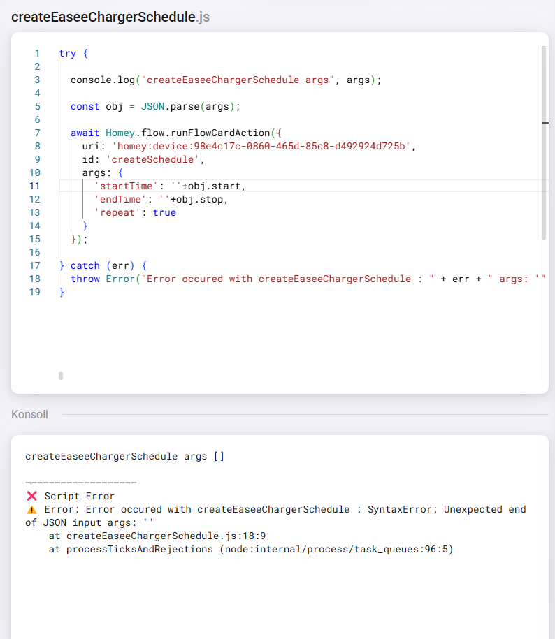

I am using a homey pro 2019 verion. Therefore using the 2019 version of the script
Still not working. Getting this error now
Only difference between this and the arguments I originally was running is removing the comma after obj.start.
Seems like it is struggling with the end time argument now
This is the error i get running the script as it was:
It seems to me that it is just missing the input, but for some reason will not take the arguments from the flow:
Maybe there is something wrong in how I have entered the arguments in the flow?
my bad, you need a comma after obj.start
… obj.start ,
That is the same as already stated in the script, but still does not work.
it still seems different. ensure that it is ’ ’
when I’m copy your code :
Interesting. I think that has to do with how it is copied in the forum. It looks correct in the script editor and I use the ’ sign. The code is a direct copy from what you have pasted in the documentation.
well in this case the issue is that the arg on line 3 is empty.
you have to pass correct arguments AS JSON …
The hard part here is that flow will send arguments as an array, but if you want to test you need to change the script like this:

Thanks a lot for helping. I was doing quite a lot troubleshooting during the weekend as was about to give up when I realized something.
When creating a normal flow that sets a charging schedule, I looked through the developer tools and saw that it is calling for the ID differently than the script (I am running a homey 2019 version)
Therefore I rewrote the script without calling for uri, but only ID and it worked :partying_face:
I can then send the arguments in a flow in the same way that is described in the documentation website.
