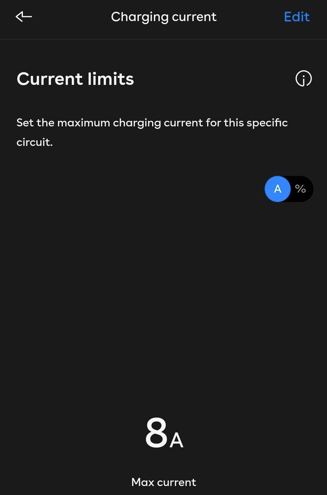

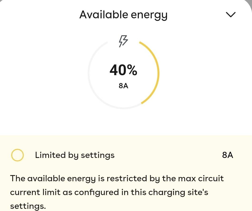

Hi @Richard_B , if I set Max. circuit limit via app (screenshot below - Charging current / Current limits), it equals to Current allocated in the Homey app and it can’t be changed anymore from the Homey (above?) this limit (which is fine I would say). Sometimes I’m using limit in the Easee app to force slow charging but it collide with dynamic power allocation I’m using to prevent overload of the house (via Set dynamic Circuit Current).
Is there some way how to distinguish between max. charge allocation set via app and via Homey app integration ? Using Easee Home charger. Just asking if I’m overlooking something. Thank you

Not sure I follow, but there are two dynamic current settings; one for the circuit (affects all chargers on the circuit) and one for the charger. You can see all possible limitations in the easee app by clicking on the flash symbol in the red rectangle below.
This will show you the below. The dynamic circuit current can in the Homey app only be changed via a flow. The dynamic charger current can be changed using the slider or a flow. The max charger current is also possible to change via a flow in Homey, but it is not recommended to change this setting regularly.
Access locked in the easee app or authorization required as it is called in the API is a “static” setting. Not sure, but assume there is a property that is changed when a charger is “dynamically unlocked”. Currently, I don’t know which one. If a car is plugged in and the charger is authenticated, then I guess it will start charging immediately?
Thank you, so actually I’m now even more confused, please take a look on the screenshots - as you can see I’m using/changing via the flash icon, it sets the Max circuit limit actually and it corresponds to the “Current allocated” in Homey Easee app - probably my confusion is caused by the fact, that I’m checking Current allocated, while changing Dynamic Circuit current - but why Current allocated is changed via Dynamic Circuit Current as well ? …anyway, I’m going to use Dynamic Circuit Current from now on, that’s probably the way to go, right.
