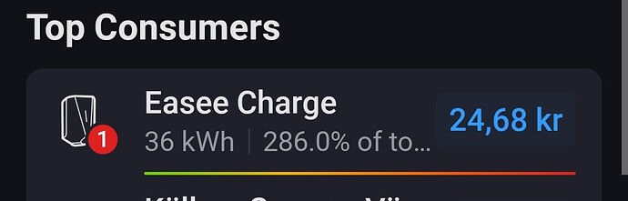

286% of total??
I don’t have solar panels.
You should ask Athom, as the only information the Easee app reports is 36kWh.
I understand but maybe someone seen the same behavour?
The total usage was 48,5 kWh
Easee usage was 36 kWh (Shown as 286%)
Heating usage was 0,9 kWh (Shown as 7,1%)
So what I figured out:
Easee usage is calculated: 36 / (48,5-36) = approx. 286%
Heating usage is calculated: 0,9 / (48,5-36) = approx. 7,1%
Conclusion: Easee usage is subtracted from total usage before calculating percentage for both Easee, Heating and all other consumers.
