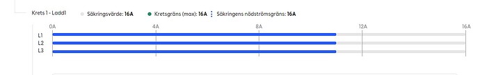

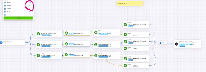

I am trying to set the dynamic charging current per phase but the charger does nothing, still on full blast.
When setting the maximum current. It reacts.
Problem is that i want to change per phase to get the most out of my main fuse instead of having to set the lowest phase for all
okey, i found out why it didnt work…
but now i have an other problem.
even nnow when i can adjust the load per phase. it will take the lowest one and apply it on all three!?
My wish was to set them individual…
Seems like your car charges on all three phases? If so, then you can’t have different current per phase. Nothing specific to a car charger I believe, all three-phase electrical devices require the same current on all three phases.
This setting to change current per phase is only useful for hybrids that only charge on one phase, then you can for instance set L1-2 to 0, and L3 to 16. Then you force the charger to use L3.
