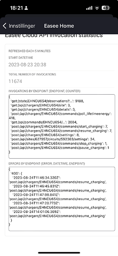

I use the equalizer as well, i have been in contact with easee to see if its possible to improve refresh rate, but they wanted to contact you and mentioned:
“I believe we need to get in touch with the developer Richard Barkestam of the Easee Plugin for Homey, because I do not know myself how they have developed it and which endpoints they use. The Easee app uses a websocket stream to receive the data, that’s why the data is updated almost in realtime.”
