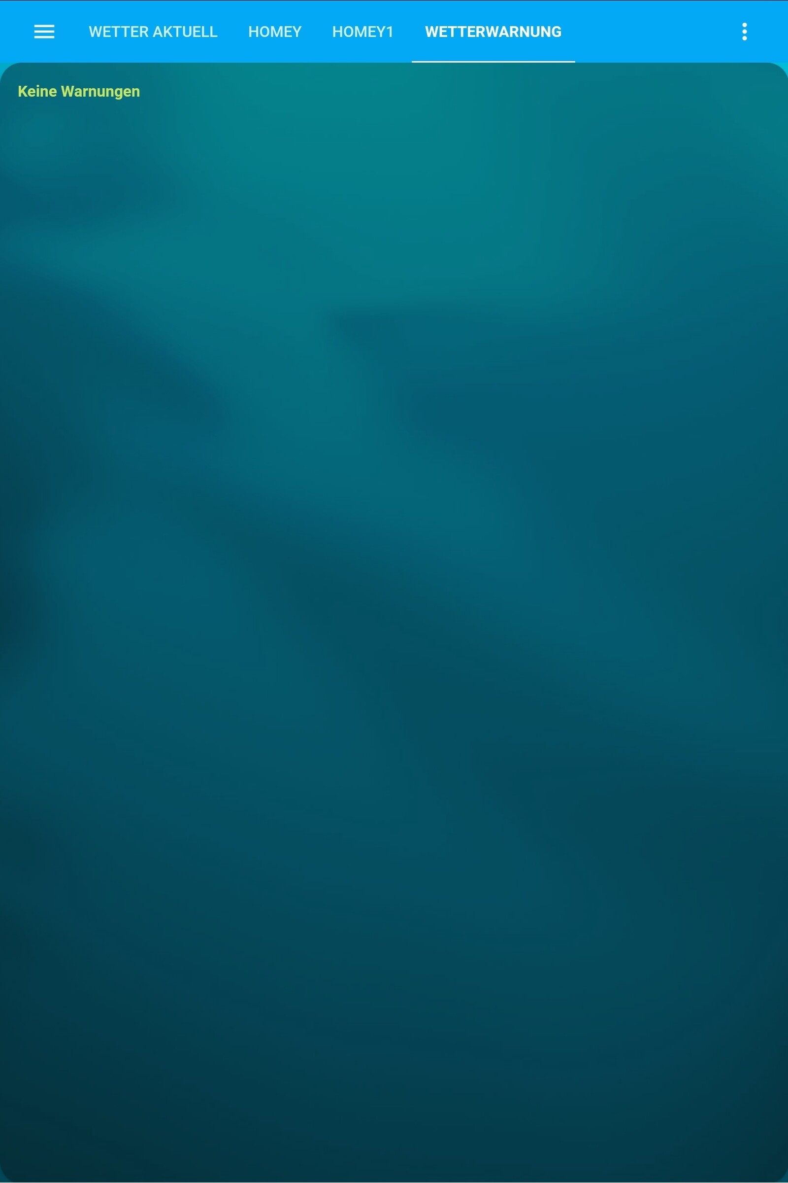

Ich habe in HA noch keine zufriedenstellende Lösung gefunden, den Langtext in einem Lovelace Dashboard anzeigen zu lassen. Ich versuche mich gerade mit Markdown, scheitere aber kläglich.
{% set level_colors = {0:'#c5e566', 1:'#ffeb3b', 2:'#fb8c00', 3:'#e53935', 4:'#880e4f', 20:'#fe68fe', 50:'#fe68fe'} %} {% set current_count = state_attr("sensor.wetter_warnung_current_warning_level", "warning_count") %} {% set advance_count = state_attr("sensor.wetter_warnung _advance_warning_level", "warning_count") %} {% if ((current_count == 0 or current_count == None) and (advance_count == 0 or advance_count == None)) %} **<font color={{ level_colors[0] }}>Keine Warnungen</font>** {% else %} {% for i in range(current_count) %} {% set headline = state_attr("sensor.wetter_warnung_current_warning_level", "warning_" ~ loop.index ~ "_headline") %} {% set description = state_attr("sensor.wetter_warnung_current_warning_level", "warning_" ~ loop.index ~ "_description") %} {% set level = state_attr("sensor.wetter_warnung_current_warning_level", "warning_" ~ loop.index ~ "_level") %} {% set time_start = state_attr("sensor.wetter_warnung_current_warning_level", "warning_" ~ loop.index ~ "_start") %} {% set time_end = state_attr("sensor.wetter_warnung_current_warning_level", "warning_" ~ loop.index ~ "_end") %} **<font color={{ level_colors[level] }}>{{ headline }}</font>** {{ time_start.strftime("%a %H:%M") ~ " - " ~ time_end.strftime("%a %H:%M") }} *{{ description|trim }}* {% if not loop.last %}***{% endif %} {% endfor %} {% if ((current_count != 0) and (advance_count != 0)) %}***{% endif %} {% for i in range(advance_count) %} {% set headline = state_attr("sensor.wetter_warnung_advance_warning_level", "warning_" ~ loop.index ~ "_headline") %} {% set description = state_attr("sensor.wetter_warnung_advance_warning_level", "warning_" ~ loop.index ~ "_description") %} {% set level = state_attr("sensor.wetter_warnung_advance_warning_level", "warning_" ~ loop.index ~ "_level") %} {% set time_start = state_attr("sensor.wetter_warnung_advance_warning_level", "warning_" ~ loop.index ~ "_start") %} {% set time_end = state_attr("sensor.wetter_warnung advance_warning_level", "warning_" ~ loop.index ~ "_end") %} **<font color={{ level_colors[level] }}>{{ headline }}</font>** {{ time_start.strftime("%a %H:%M") ~ " - " ~ time_end.strftime("%a %H:%M") }} *{{ description|trim }}* {% if not loop.last %}***{% endif %} {% endfor %} {% endif %}

Danke für deine Mühe, aber in Markdown wird leider nichts angezeigt. Die Anzeige bleibt auf “Keine Warnungen” stehen, selbst wenn eine Wetterwarnung vorliegt.
Das kann an der Länge der HA-Entitäten liegen (255). Längere Texte werden nicht übernommen. Das müsste man als Fehlermeldung im HA-Log sehen.

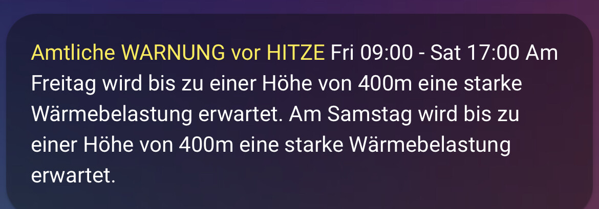

Auf meinen zwei LaMetric Uhren ertönt ein Warnton und die Meldung läuft im Langtext durch. Die LaMetrics und HA wiederholen die Warnung alle 15 Minuten, solange die Meldung aktuell ist.
Entwarnung wird auf die gleiche Weise gegeben.

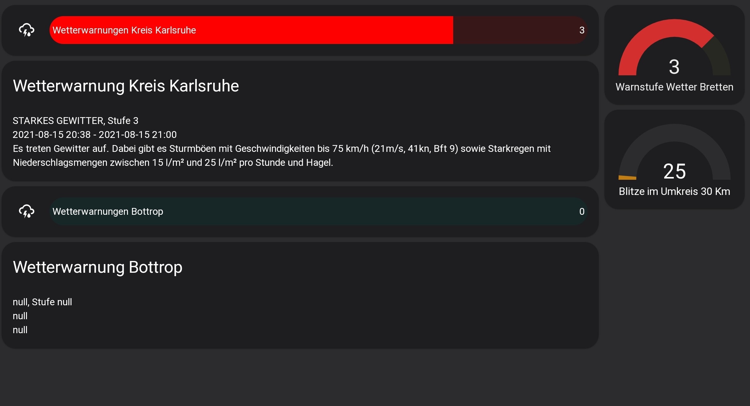

Verwendung in HomeAssistant:
Wenn die Geräte mit dem Homey MQTT Hub an HA übertragen werden, dann stehen diese als Entitäte zur Verfügung.
Hier eine Visualisierungsbeispiel:
grafik
Für das Balkendiagramm verwende ich ein HACS Custom-Control (mini graph card - GitHub - kalkih/mini-graph-card: Minimalistic graph card for Home Assistant Lovelace UI).
Die Lovelace-Einstellung dazu sieht wie folgt aus:

Das Textfeld ist ein Standard Markdown-Element. Hier werden die einzelnen Attribute der ersten Warnung angezeigt:
type: markdown
content: |
  {% if ( is_state('sensor.alzey_worms_warnung_1_stufe', '0')
        or is_state('sensor.alzey_worms_warnung_1_stufe', '' ))  %}
   Keine Warnungen vorhanden.
  {% else %}
  states('sensor.alzey_worms_warnung_1_typ') + ', Stufe ' +
  states('sensor.alzey_worms_warnung_1_stufe') +
  '\n' +
  states('sensor.alzey_worms_warnung_1_zeitraum') +
  '\n' +
  states('sensor.alzey_worms_warnung_1_beschreibung') +'\n'
  {% endif %}
Die Beispiele sind etwas zusammengebastelt aus verschiedenen Kreisen. Nicht wundern über due Zusammenstellung.
