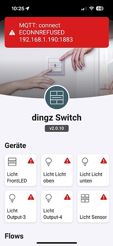

I can’t get any further. I always get the same error message: MQTT: Connect Econnrefused 192…: 1883.
Many thanks for your help
