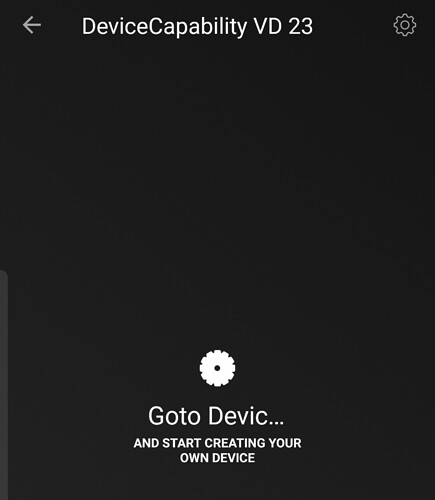

  1. Not sure how many Homeys use the mobile app (I like fiddling on my phone), but this message falls off :wink:
Maybe ‘To start’ and then ‘goto Device Settings’ fits better?

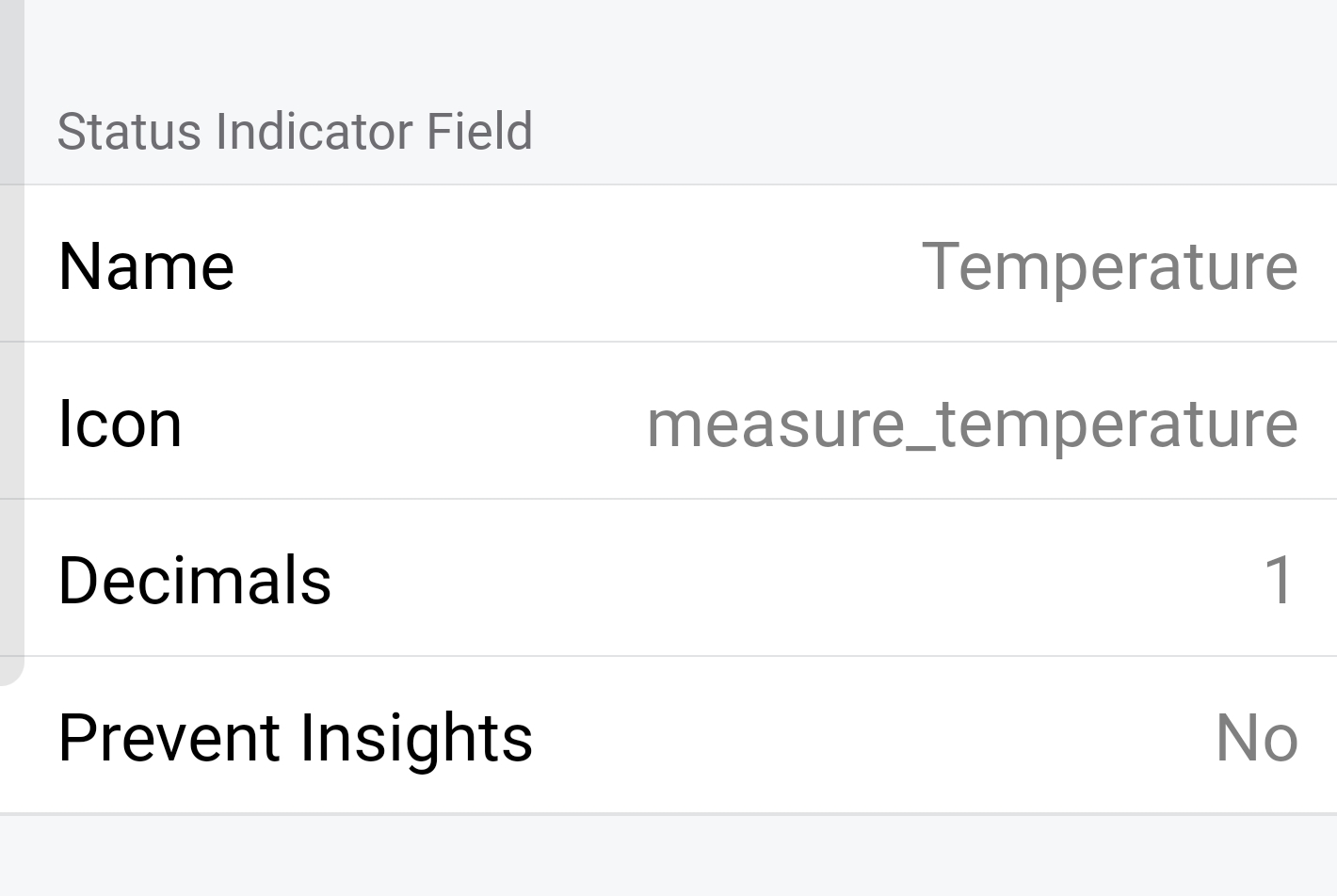

  2. About Status Indicator,
    When I enter all fields for the Status indicator and save it,
is it possible to automatically set the tile’s Status Indicator to the new status?
Now it stays on ‘None’ and has to be selected afterwards :grimacing:

  3. No, you need to set that yourself on the Mobile App (as far as i know you cannot even do this in Web App? If so, let me know and i’ll find a way hopefully)

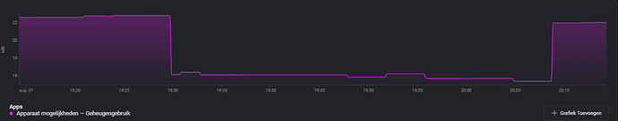

Just some FYI performance analyses:
I just disabled the App and Device OnInit’s, and removed all (couple of hundredths) possible capabilities.
Installing DC (not debug mode) starts off with 16.2MB memory.
Then i placed the capabilities back and installed: 16.2-16.4MB Memory, not much difference.
I added 10 more custom icons to the capabilities: 16.3MB.
Now i added the 10 new custom icons to the settings for all fields, makes the app.json jump from 24574 to 26974 lines: 15.7MB.
(dont know why)
Lets try adding 10 more custom icons in the capabilities and settings: 15.43MB…
Funny, should we add millions? :wink:
Now we turn the App OnInit Back on: we jump to 22MB.
And now the Device OnInit (only have one devicetype (Virtual Device) and have 4 off them): 22.1MB.
So we can can conclude it is not the size of the app.json (capabilities and longs settings) that increases memory :slight_smile:
Great, i have currently added to a total of 40 custom icons!
The memory is probably used by the athom-api, but i will look into it more after translation is done.
After changing some virtual devices and there properties, memory goes from 22 to 21 to 21.6mb. Holding steady.
After loading all possible capabilities active in the memory, by selecting all options and icons, my memory goes up to 25MB.
Not to bad i.m.h.o., allthough i will look into the app oninit and the 6 MB it cost. But i do have watchers for the flowcards.

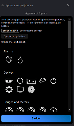

Added some more icons and beter view when creating a device:
The allready custom uploaded icons can now also be selected when creating a device.
I changed the settings dropdown for icon to show categories aswell:

YES! This can now be done!!!
Pick a custom icon as, for instance, custom_2. You can pick it without setting a icon first in settings, but it makes it harder to pick:
Now this will be it’s icon:
Now goto settings and change the custom_2 icon.
Now restart the Device Capabilities App!
Tada, icon is changed :slight_smile:
