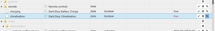

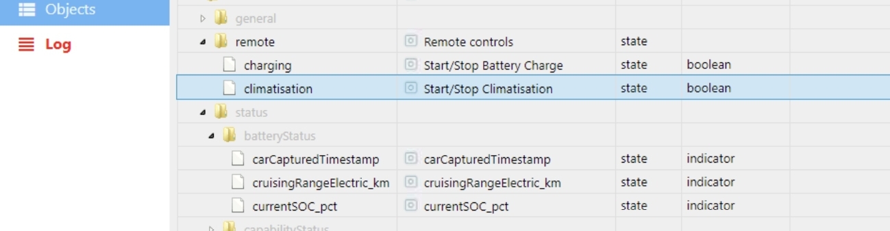

How do you start the climatisation with iobroker via MQTT?
I have enabled that functionality in iobroker, but what the message look like that you broadcast from Homey?
Actually I haven’t tried to use MQTT to start the climatisation, I just changed the value in the IObroker to test.
My guess is that you have to write “true” or “false” string to your id3/startclima topic.
Just for your info, it was quite easy with true/false. I get the value to change to true in iobroker. Only one time I got the heater to start, but mostly nothing happens. Can it be a delay in the communication between car and iobroker?
Within a couple of minutes value pops back to false.

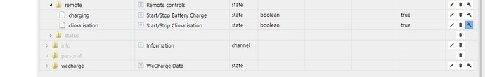

Did you got the climatisation control to work from homey? I’m trying to write “true” in the right topic, as in your example “id3/startclima”, but the value doesn’t change in the IObroker.
Well, yes, and no. I can change the value but it does not start the clima
I had wrong topic, now I’m able to change the value.

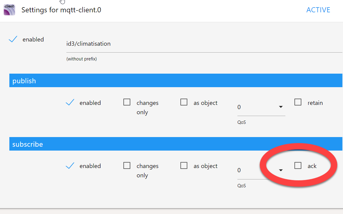

I noticed the same effect that heating doesn’t actually start or starts every now and then. It seems that when you take of the “ack” checkmark the heating is started more often (that might also be coincidence)
Yes, I tried to uncheck the ack box and that did the trick. I will try it back and forth to see if it can be used in real life situations.
