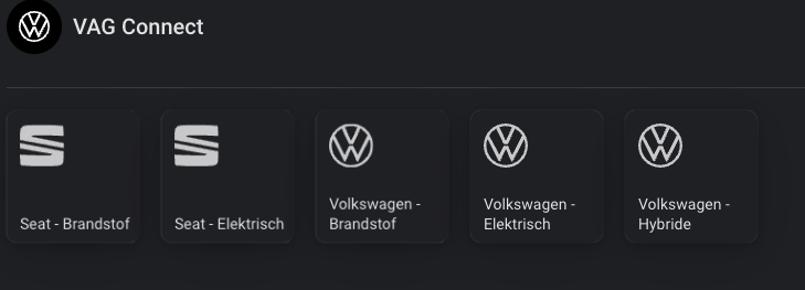

Still in early stage but I have a test version ready. For now only VW & Seat cars. Once I finished VW I’ll start on Audi
Please note: This app is still in testing phase
Some explanation:
There are 3 different car types defined in the app. EV/Fuel/Hybrid.
Not all cars share the same functionalities.
E.g. my Golf 8 doesn’t have climate options while a GTE does. They do share the same API.
So I made some toggle-able functions. When you go to the device settings you’ll see them (for now only 2.)
