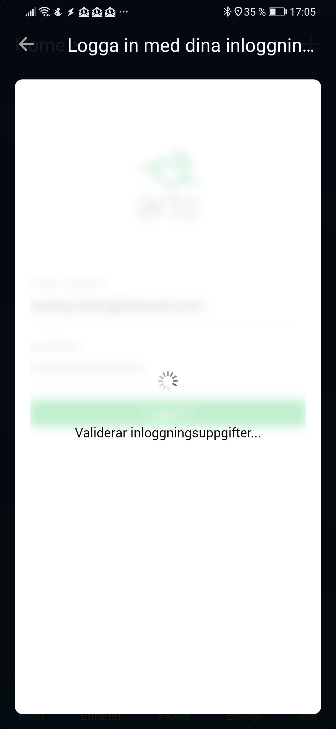

I followed the instructions but I’m not able to connect
I figured it out, I needed to disable two way verification in arlo app.

I cannot add any device. It says there is no device to add. I do have VMB4000.
May be that I didn’t follow your instructions. I first went to config app and logged in. I tried logging out, and redoing with add device, but it logs in automatically.

@nmeden It should be possible to connect first from the settings, with out any issue. Can you please delete the app, re-install it. Attempt to add your device and when it fails to find your base station - send a diagnostic report.

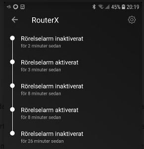

Not sure if this has already been noted but for me it appears as though motion detection in homey is working perfectly fine after a restart of the Arlo app but 5/10 minutes later it doesn’t seem to respond to motion anymore.
Is this something anyone else noticed as well?

Yes, I have similar problems. Yesterday I tested a few times without any issue. The motion flow worked perfectly sending a message to my mobile phone.
After that I haven’t touched either Homey or Arlo.
I forgot to put on geofencing today and I have had a lot of detected movements from netgear during the day when I was walking around with activated cameras. But not a single message on the mobile from the Homey arlo app!
I will test sound motion flow when I have time for it.
Edit: Restarting the homey arlo app fixed the problem. Havent tested for how long though
