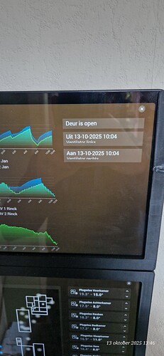

Hello Erik,
i’m using youre DataVista app a lot, great app!
yesterday i made some label widgets on the dashboard. and i noticed the overwrith name is not very nice to see on a samsung a9+ tab, i don’t know how it happens ore maby it is a setting on my side?
but i tought lets mention it. if it is not a setting problem from my side and it is a small effort to adjust then that wil be nice but only for the aesthetic, but it works so if it is a big rewrite in code i sould leave it the way it is.
This is how i looks on the tab a9+
And this is how i looks on my phone, i’m guessing that is the intended way
