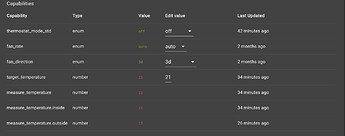

Over the weekend I was cleaning up the flows I have around my airco units and ran into a challenge: retrieving the operation mode of a unit. The reason for this is that I don’t want to set the operation mode to cooling if the unit is already cooling.
There is a card to test if the operation mode of a unit equals to e.g. cooling but that comes always back as false. And that is the case for all modes on all units.
I can set the units to every operation mode I want so there is no communication issue.
My app version is 5.0.16 and Homey is on 6.1.0. Adapter is BRP069Bxx.
Is this a known feature or am I doing something wrong?
I also noticed that there is - in my perception - odd behavior on the tiles. The circle behind the temperature on the tile is turning blue and black but that does not match the operation mode (cooling and off). Or is blue telling me that the measured temperature is higher than the target and I should be cooling?
Final for now: Can I see the operation mode in Homey Developer Tools?
Thanks!
Ed

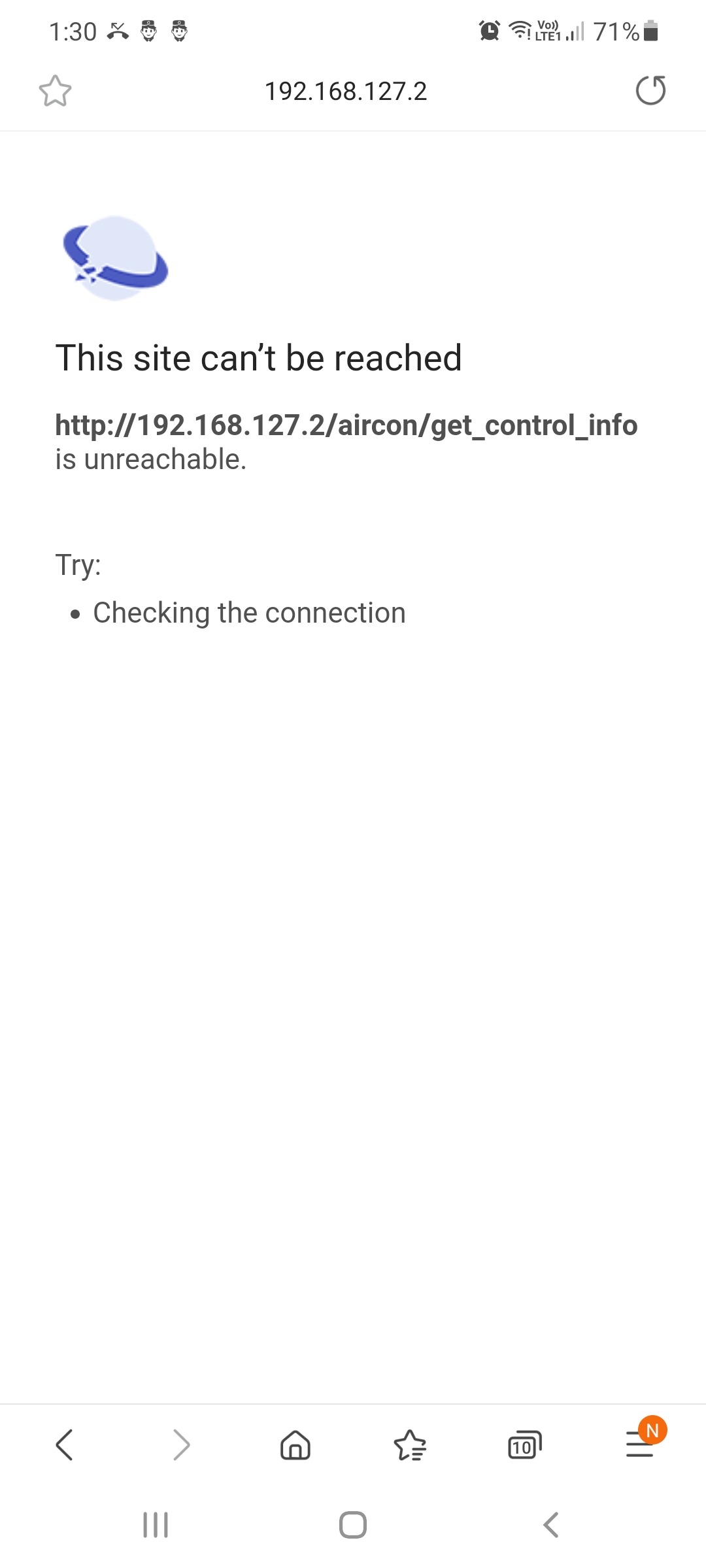

I’m having a hard time connecting my new Daikin US7 to homey. I’ve read lots and just cant get the connection.
AC is Daikin FTXZ25N
I’m in Australia and the WiFi adapter for the Australian App I read is not compatible, so I have purchase from the US, BRP069B41 adapter.
I can connect my smart phone to the adapter wifi signal, however I am unable to:
a) connect direct to Homey, I get the red message “your settings are being saved now…” and then nothing gets added.
b) connect the adapter to the actual Daikin AP (not sure if the problem is related but I assume it is) It keeps telling my my smart phone is not connected, when it actually is connected.
Is there something wrong with the wifi settings, or what might I be doing wrong?
Trouble shooting step #1
Open a browser open this url http://xxx.xxx.xxx.xxx/aircon/get_control_info (were xxxx is the ip of your airco).
Response should be like:
ret=OK,pow=0,mode=0,adv=,stemp=21.0,shum=40,dt1=21.0,dt2=M,dt3=22.0,dt4=25.0,dt5=25.0,dt7=21.0,dh1=40,dh2=50,dh3=40,dh4=0,dh5=0,dh7=40,dhh=50,b_mode=0,b_stemp=21.0,b_shum=40,alert=255,f_rate=A,f_dir=3,b_f_rate=A,b_f_dir=3,dfr1=A,dfr2=5,dfr3=A,dfr4=5,dfr5=5,dfr6=5,dfr7=A,dfrh=5,dfd1=3,dfd2=0,dfd3=3,dfd4=0,dfd5=0,dfd6=0,dfd7=3,dfdh=0
Please report.
The feature is called ‘users own mistake’ :wink: This is working fine for me.
This is by (SDK) design, the color has nothing to do with the on/off state or mode of the airco.

Hi Peter,
I am unable to connect with the link!!!
I just get the site cant be reaches error (both when connected to my wifi and also the daikin wifi adapter)

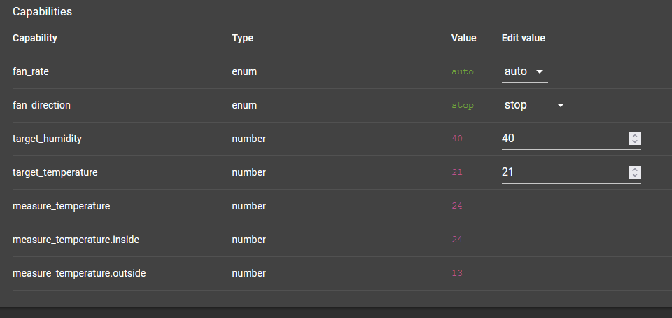

I’m glad that it works for you… I don’t see it.
If only I understood where my mistake was… Could this be using the value of the thermostat_mode_std capability that I don’t have?
Ed, try to ‘re-pair’ and see what happens, trouble shoot…
So that is the problem… as long as this fails my app nor Homey can communicate with your airco.
What is the official Daikin app called you use to control your airco?
