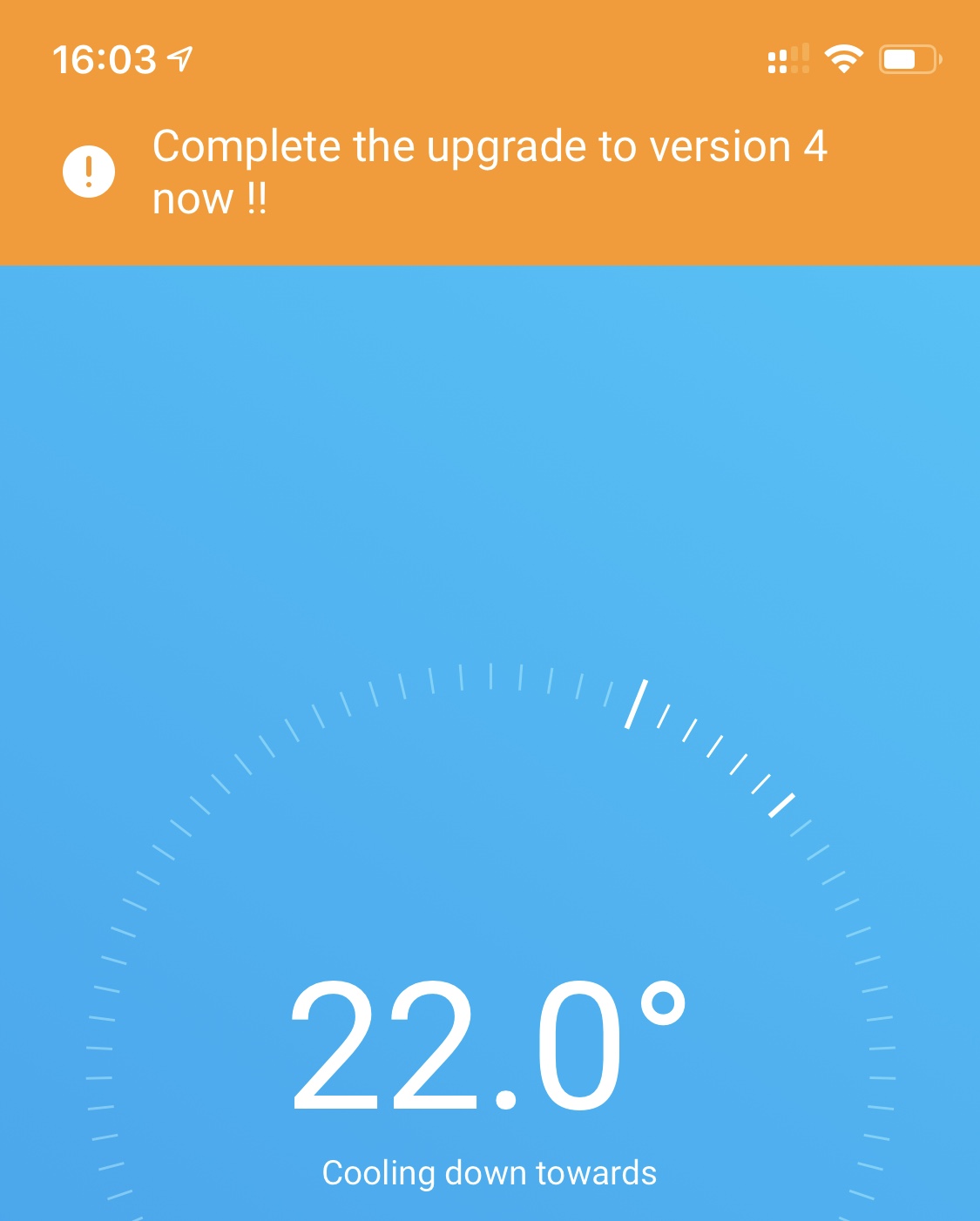

Version 4.0.5 is now available on test.
Existing special mode users that upgrade from version 3.x.x to version 4.0.1 and up will now see a warning message that they should complete the upgrade procedure…
When this message is shown go to the maintenance menu and perform the RePairing procedure.

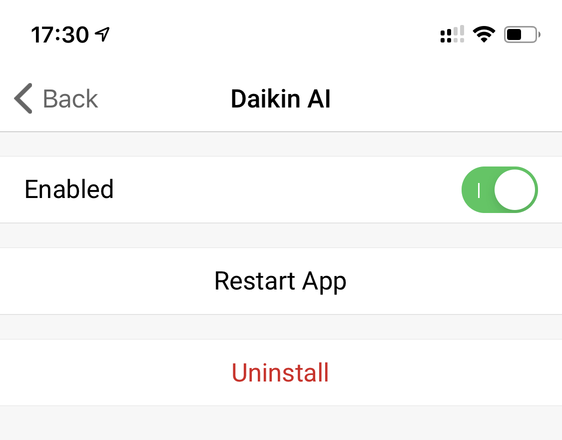

After completion of the RePairing procedure stop/start (Restart App) Daikin AI to clear the warning message.

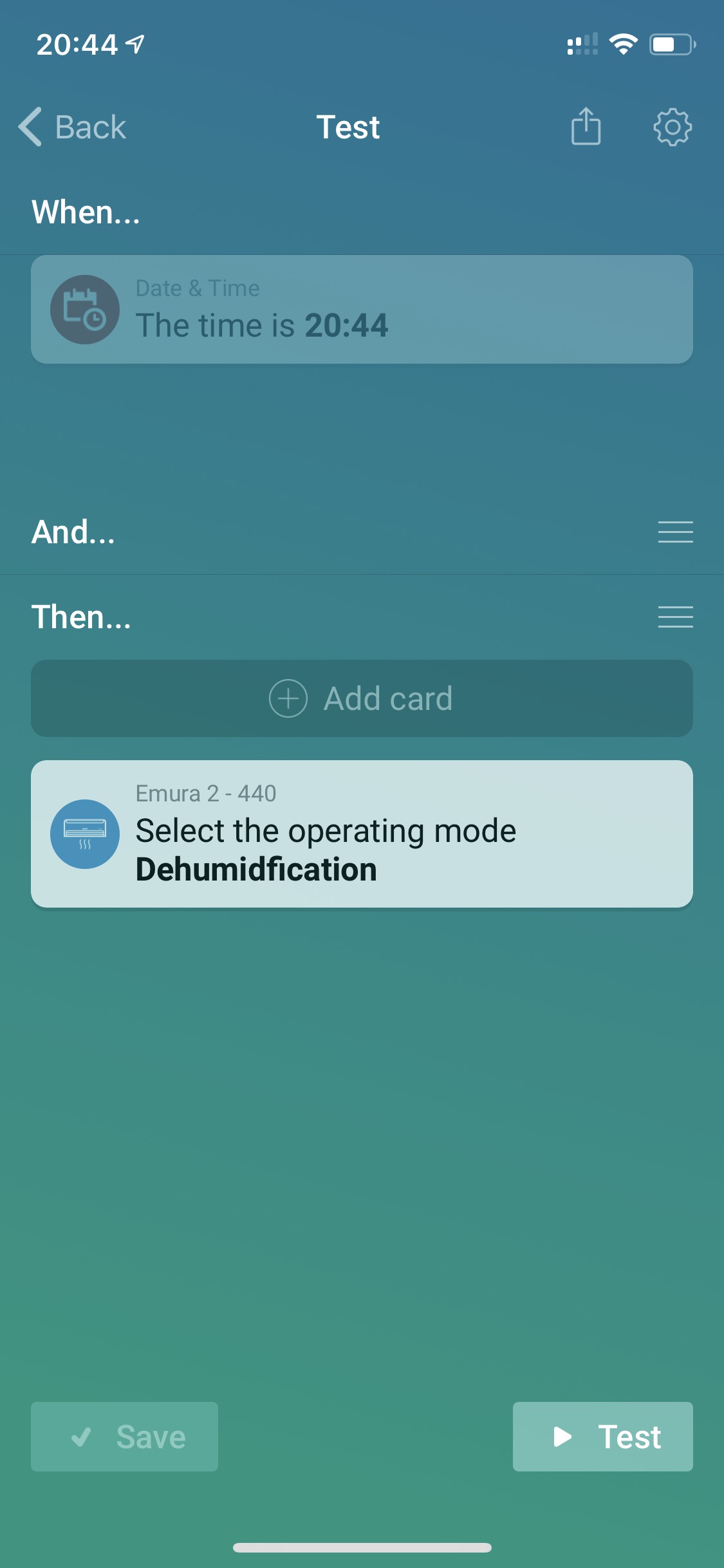

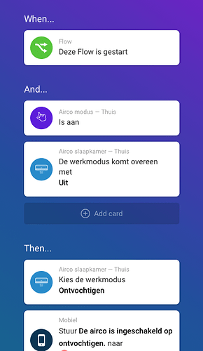

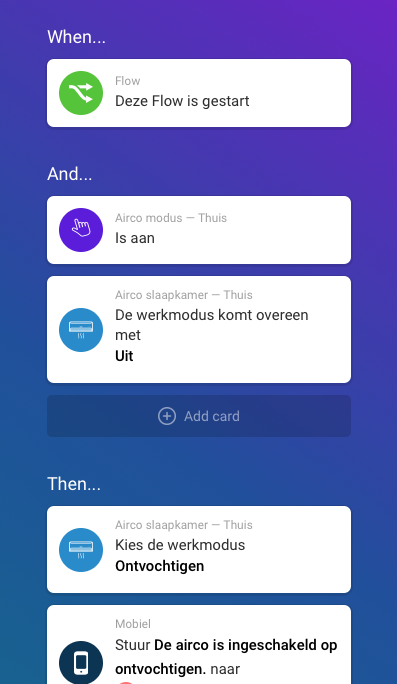

I have the following issue: the ‘ontvochtigen’ mode cannot be triggered. The app is working smoothly and other modes, like cooling, work just fine.The flows are correct since message cards are triggered.
Model FTXM25N2V1.
Any idea on what’s going wrong?
regards,
Andy
Try version 4 and report again. Add a 5 sec delay to the ‘then’ part.
This simple flow does work in version 4.0.4.
