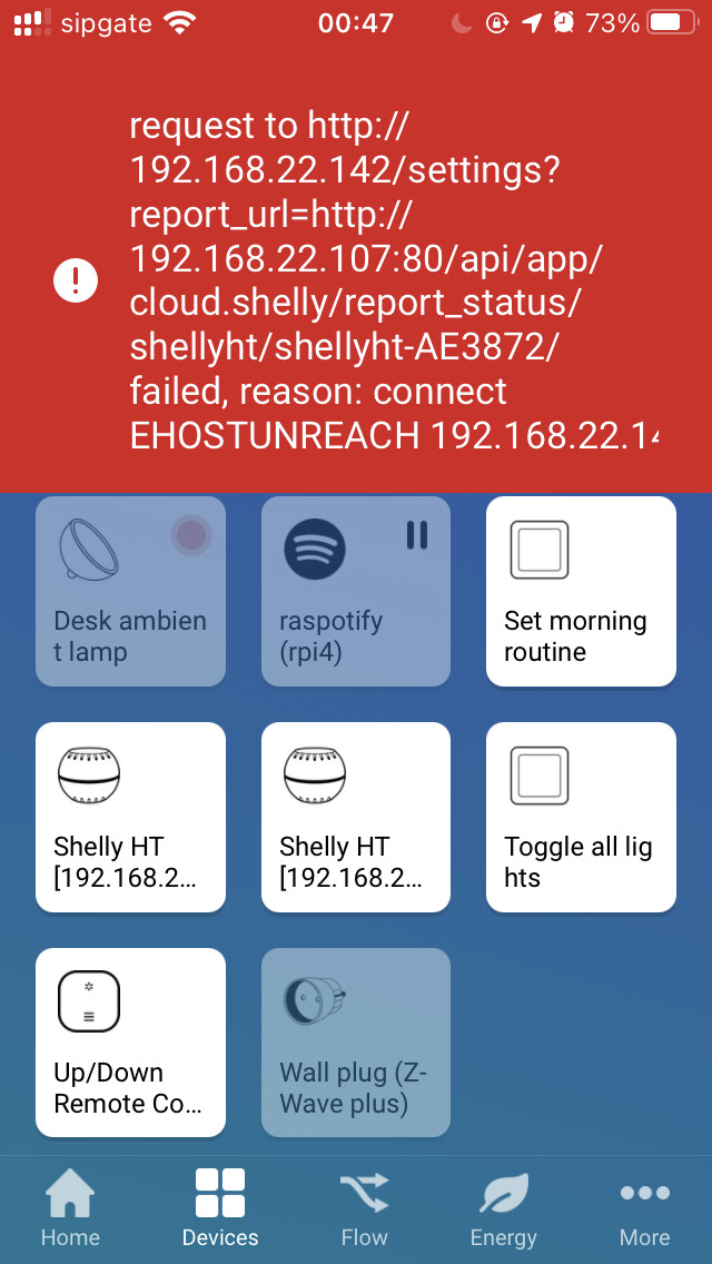

Hi, I was playing around with H&T sensor. (I recommend to manually update the firmware of the device first of all)

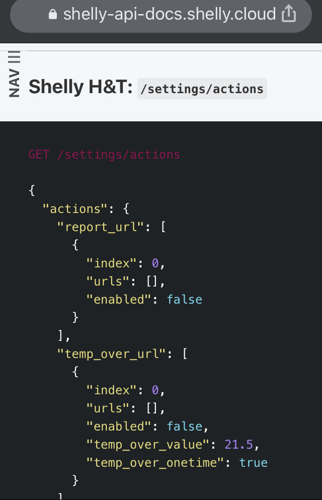

I think the homey shelly app is trying to call old api:
The “action” part is added. It looks now like that:
Ps. Is there any purpose of two buttons in the device view?
You are correct. This is broken in the v1.x version of the app. I probably wont be solving that anymore as I’m focusing on improving the v3.x version of the app. Read more about it here: [APP][Pro&Cloud] Shelly - #1097 by Phuturist
