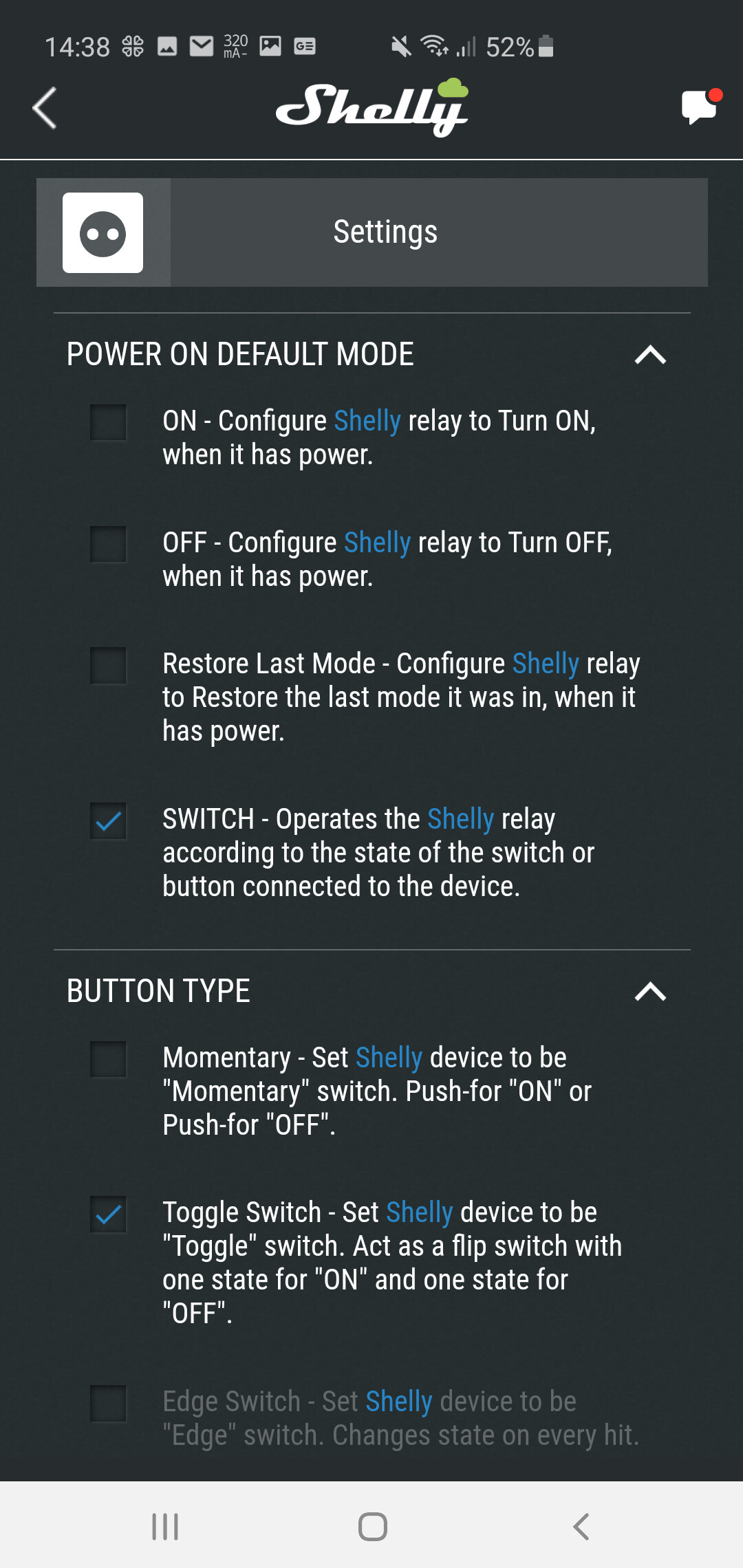

Read the instructions, I’ll try thanks
Edit. Been trying for half an hour now but can’t get it to work any suggestions?
The button switches don’t stay enabled and there is no way to choose the shelly and the button pushed.
For Push-button function, you need Momentary- Set
Yes don’t have it yet. Was trying to test it with on/off on a regular switch with detached mode on
How are you going to long press a toggle switch?
Well there is a toggle switch installed right now, so I can assign the toggle on/off signals to a action or flow right?
Yes, called turned on and off. That’s done through the light card itself, not the action card as far as I know.

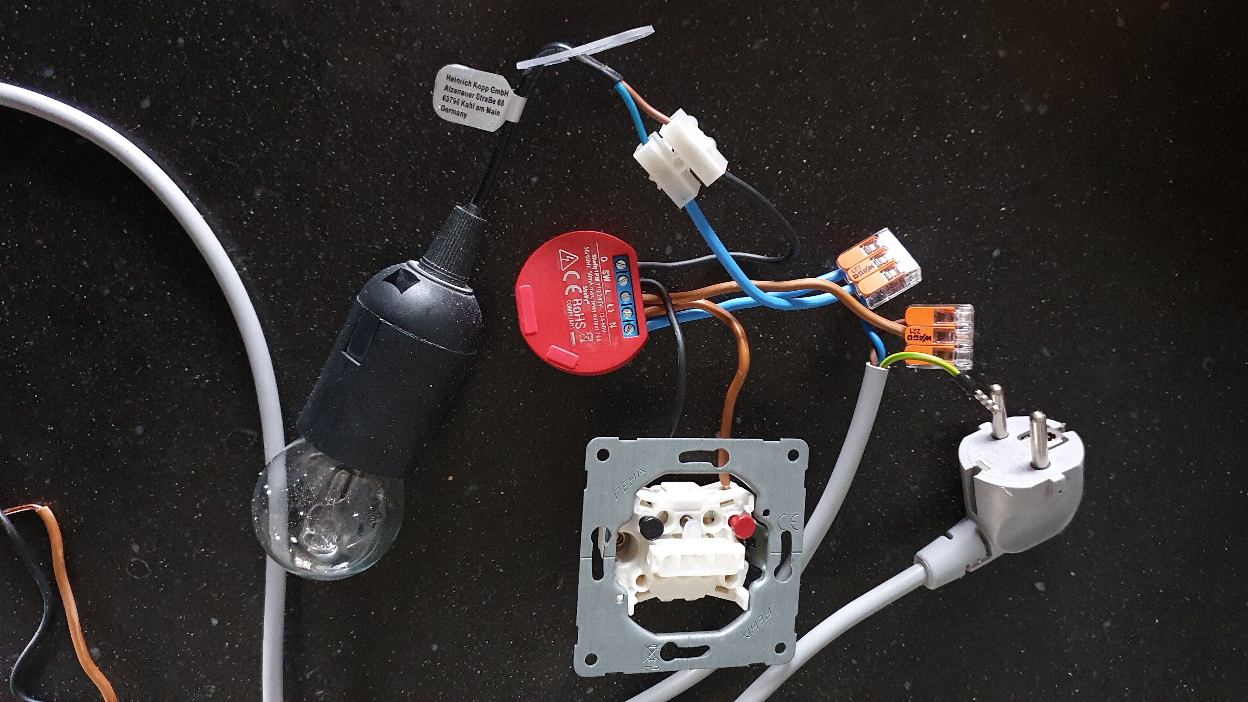

anybody who is willing to help a bit? I have got a test setup with a momentary switch and tried several of the above but it doesn’t respons to what I want to achieve.
I cant get the action cards in Homey, so selecting the right shelly and the action that is used.
I followed the tutorial in the start post even with the Logica but there is no way to select a Name or an Action. In detached mode, is it even possible to register a physical button push?
edit: i’ve got some new stuff going on but can’t interact with it
it disapears after a while but it is definetly triggered after the maintenance card on Homey

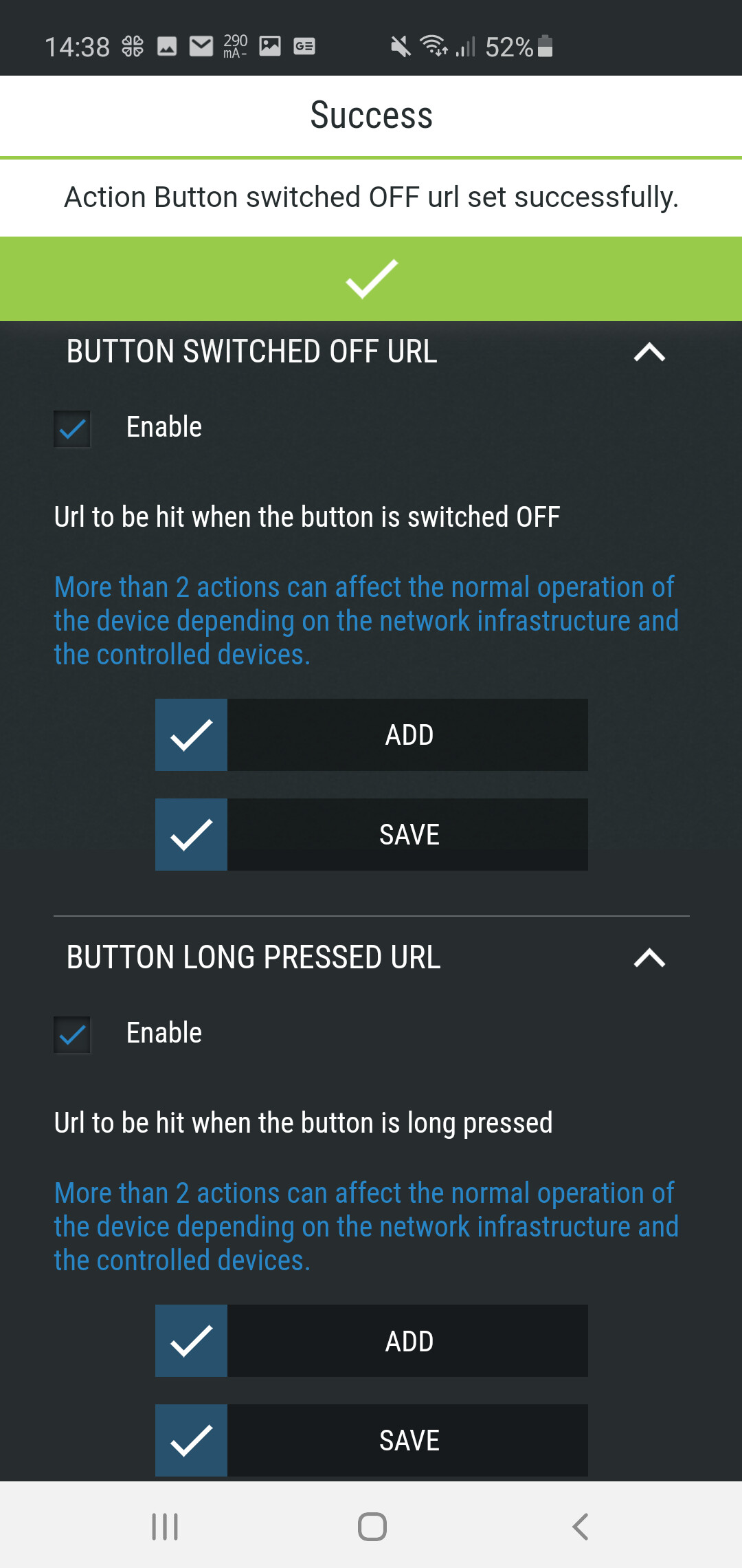

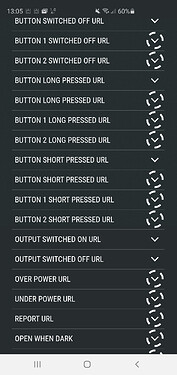

Trying to setup URL actions for a Shelly 2.5
Is this still supported? (My homey is not on v5) As per openingpost I can use the “maintenance” option in Homey, but it doesn’t set anything in the 2.5 although it reports back positively
Also tried to setup my url manually, but I don’t really know where to look for the correct codes and it’s not something I’m familiar with
https://shelly-api-docs.shelly.cloud/#shelly2-5-mqtt
It works good on several dimmers I have (using the maint.option in Shelly app), so I got this far
http://192.168.1.200:80/api/app/cloud.shelly/button_actions/shellyswitch25/shellyswitch25-40F5202A5412/close/
but it doesn’t work
Obviously not using the right setup. Any help?
Also read somewhere that this is not supported anymore on V5 Shelly app? Can’t find this anymore however (I really can’t get used to this type of forum … :’( )
Setting up action URL’s does not work anymore on the v1.x version of my app. Shelly devices that have been previously configured will continue to work. On the v3.x there is no need to setup these action event URL’s as the events are send over a different protocol. So the functionality is still there (and improved a lot) but does not require to set up the action event URL’s through the maintenance actions.
