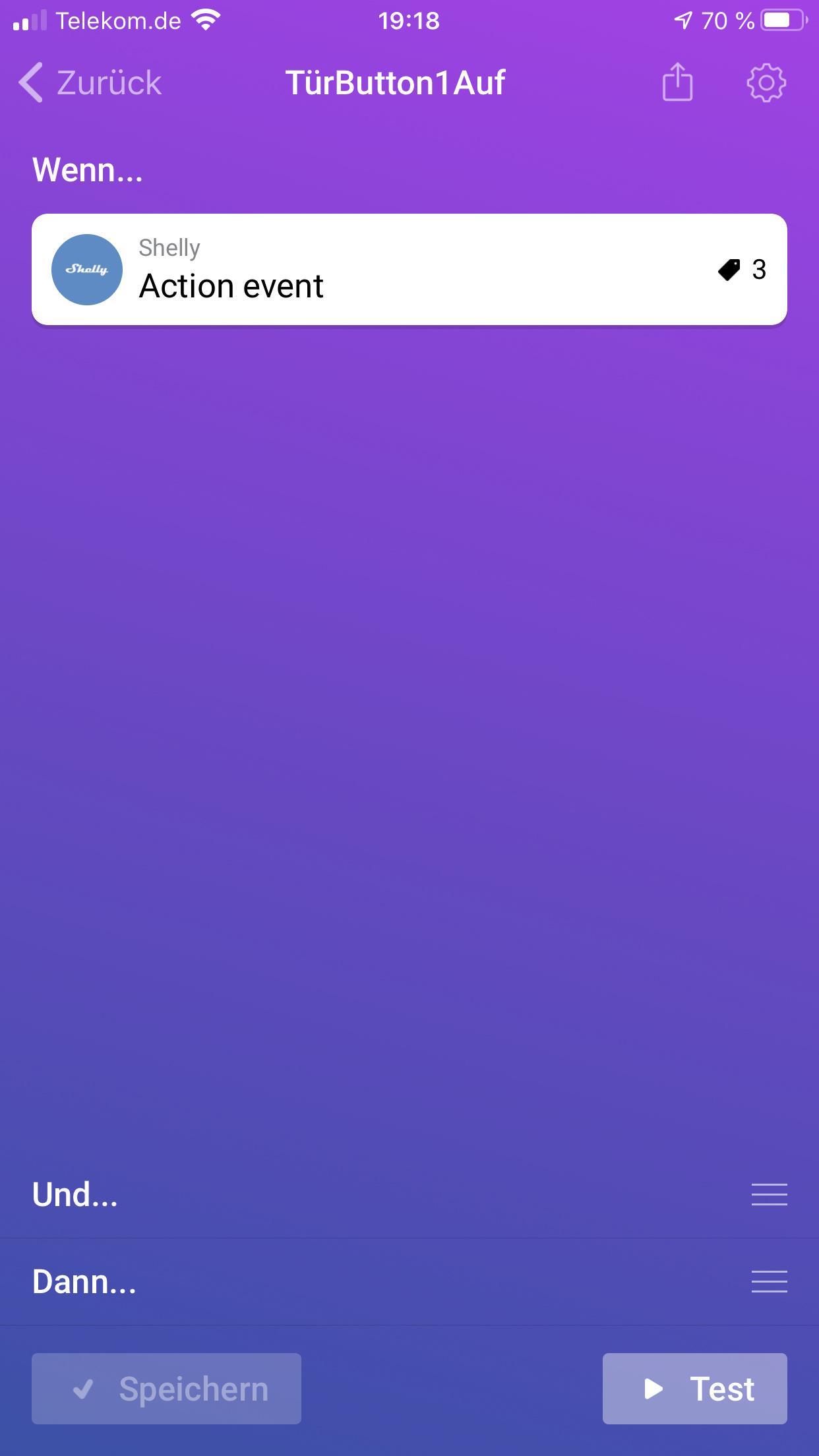

Hello, everybody! I recently converted my smart house to Shellys devices. So far I have had only positive experience with them, so in terms of stability and price. I have installed a switch in the hallway (momentary) with Shelly 2.5, it works fine so far. But how can I program double / triple pressure? Can someone please help me?
Vielen Dank fĂźr Ihre UnterstĂźtzung, das bringt mich schon ein StĂźckchen weiter. Ich habe noch die âletzteâ Frage )) Wo kann ich denn nachschauen welche Befehle es allgemein gibt und wie diese auch heiĂen (z.Ă. âtriple_shortpushâ)?
P.S.: ich habe die Aktion gerade ausprobiert - also mit dem Button1 funktioniert es eiwandfrei aber nicht mit dem normalen Schalter (Taster fĂźr das Licht im Flur). Ist dieser Befehl nur fĂźr Button oder mache ich was falsch? Ich danke Ihnen noch Mal!

Thank you very much for your support, that takes me a bit further. I still have the âlastâ question )) Where can I look up which commands are generally available and what they are called (e.g. âtriple_shortpushâ)?
P.S.: I just tried the action - it works with button1 without a protein but not with the normal switch. Is this command only for Button or am I doing it wrong? Thank you again!

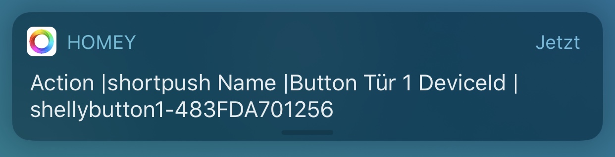

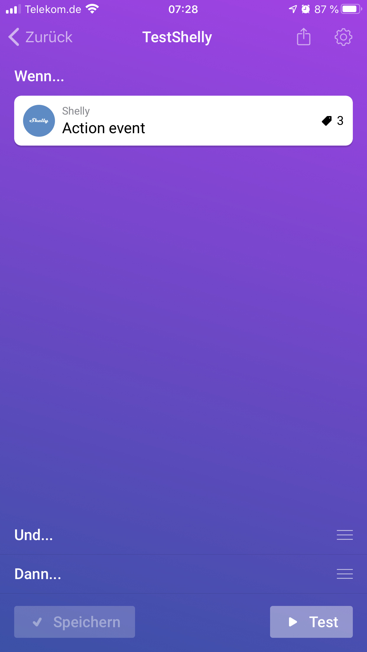

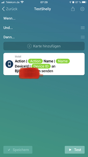

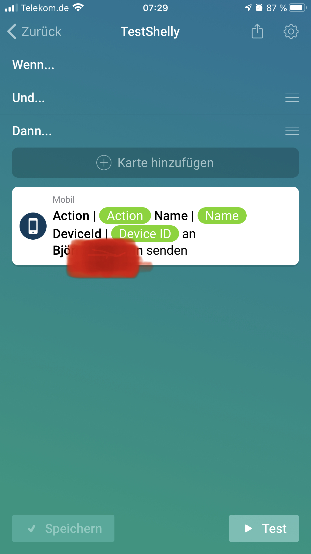

Just use a flow where you send the tag as notification to your mobile device and perform the action on your Shelly (for instance by double clicking the button on a switch). It will send you the corresponding tag to your mobile device and you can then just copy it as condition to a flow. In the future I might improve how this works.

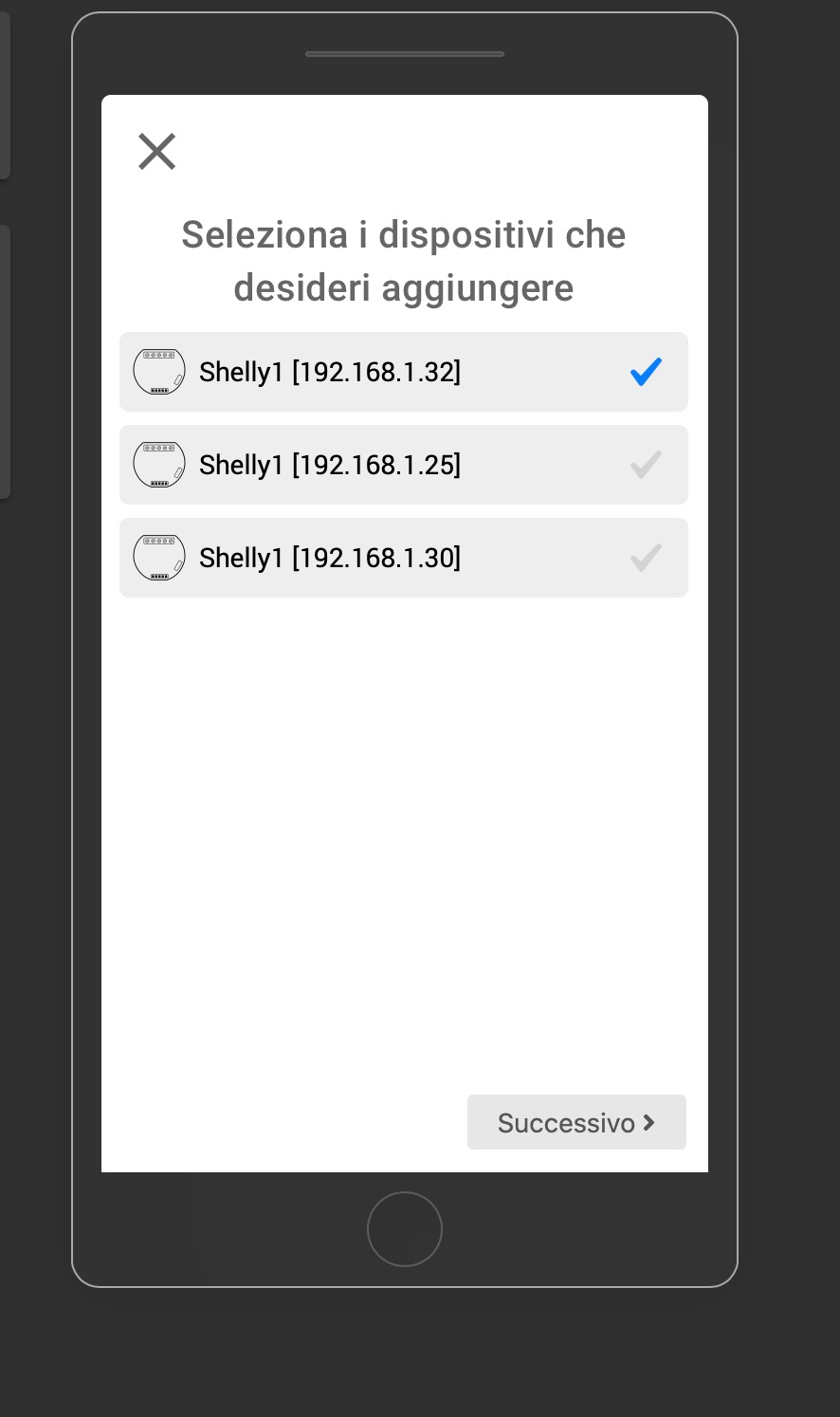

Iâm trying to add a new one but the app do not show me the device, instead show me 3 of the 6 already added
I understood that the fact the app show me some of the already added devices is normal, I read the previous posts but I do not understand why it do not find the new shelly I need to add. The class ip is the same
and the device is x.x.x.24. I tried rebooting app, rebooting shelly, rebooting homey but always stuck there.

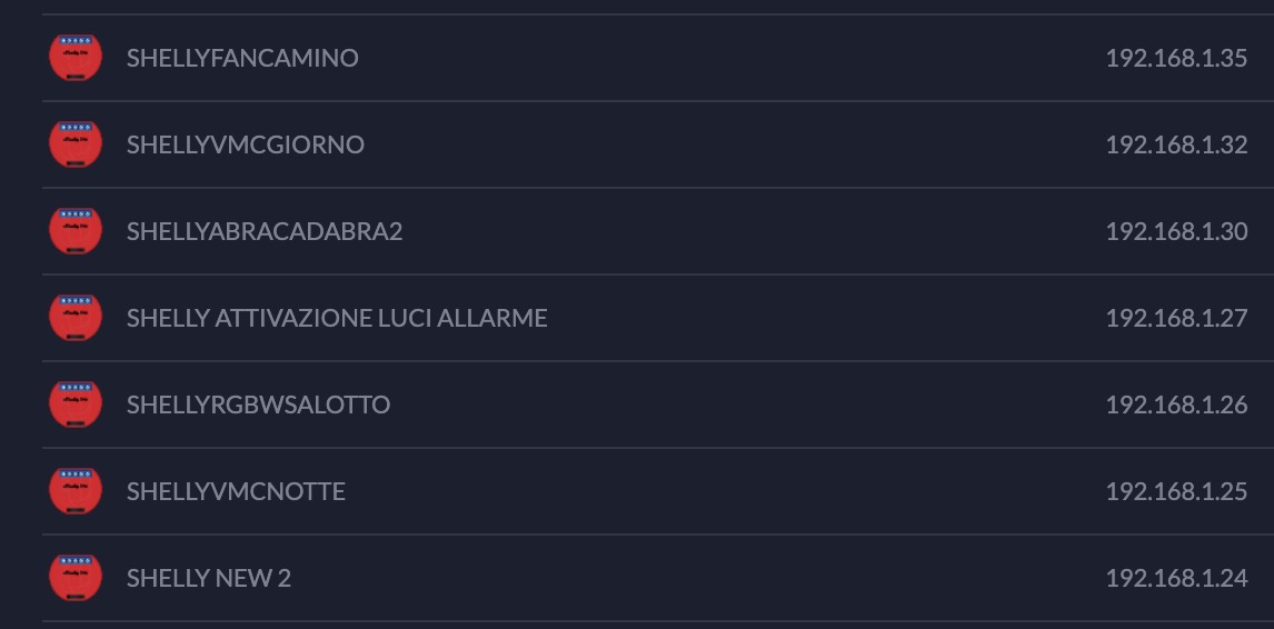

do not look at the shelly 1 PM red color, I just use this icon on my unifi network because it is the only one existing, they are all shelly 1 and 1 shelly rgbw
If itâs showing devices that are already paired it probably means you paired them a long time ago when there was no auto discovery yet. The device identifier which is registered with the device changed when I introduced auto discovery meaning it now recognises these Shellies as devices that are not paired yet and thus shows them in the pairing wizard. A solution would be to re-pair them and fix your flows afterwards.

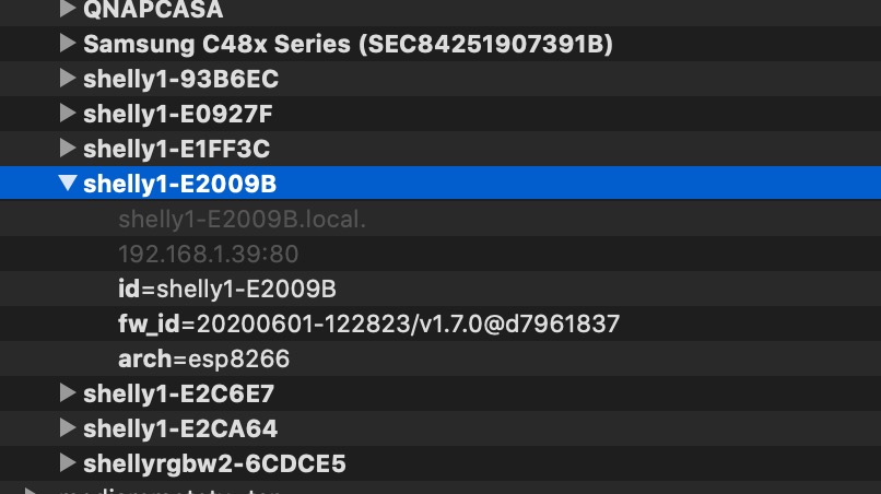

Why itâs not showing the new Shelly riddles me. The only thing I can think of is that you are trying to pair it as Shelly 1 while itâs actually a different type, a Shelly 1PM for instance? Another thing I can think of is that itâs at the end of your WiFi network and does not respond to the mDNS broadcast send out by Homey during discovery. Can you discover it using a tool like Discovery for Mac or Bonjour browser for Windows?

About the second part YES I can reach with discovery app ( I changed ip to .39 )

If it has been added before there might be some caching going on where it thinks the device is already added. But a reboot or even a restart from the app should have solved that already.
You can also manually pair Shelly 1 devices but this option is only given when no devices are found to pair. Since your Homey is showing devices that option is not given (even though these devices have been paired under a different device is already). Re-pairing these devices so they donât show up anymore in the pairing wizard will give you the option to manually pair the other Shelly.
