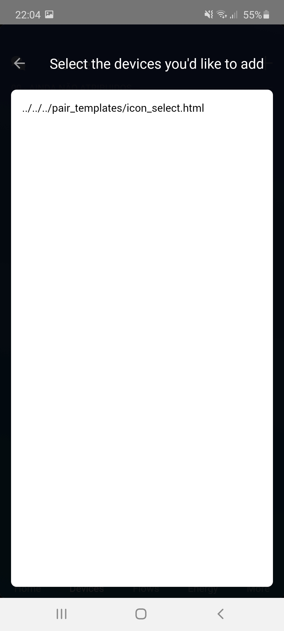

Bought a Shelly Vintage 125mm, but I can’t add it to Homey:
after adding it (and choosing the 125mm type) I get this
image|400
Yeah, the latest update broke pairing for all Shelly devices. Will see if I can fix it later this evening. Tried to update the app from a small laptop I use on my holiday but that turned out to be a bad idea. Bare with me.
This problem has been solved. Check: Homey offline/onbereikbaar?
ah no problem, didn’t know there where other problems
Hi The issue is not solved with the homey connection being resolved, I’m am also not able to add Shelly Vintage devices today.
Same problem here. New Shelly Vintage, but unable to connect with Homey. Same issue as printscreen (/pair_templates/get_device.html
Please see previous comments. Is being taken care of.
