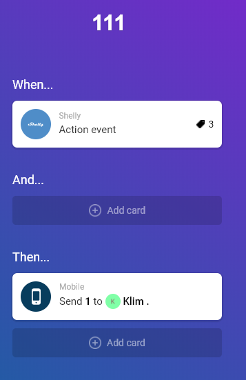

Okay, thank you. I’m trying to trigger flow to any action and any Shelly device, but nothing happens.
I’m doing it right way?
I’m pushing button connected to Shelly i3 and i can see on/off icon changing in web interface of Shelly i3.
But no triggering from Homey.
Please follow the instructions from the first post in this topic to setup the notifications.
