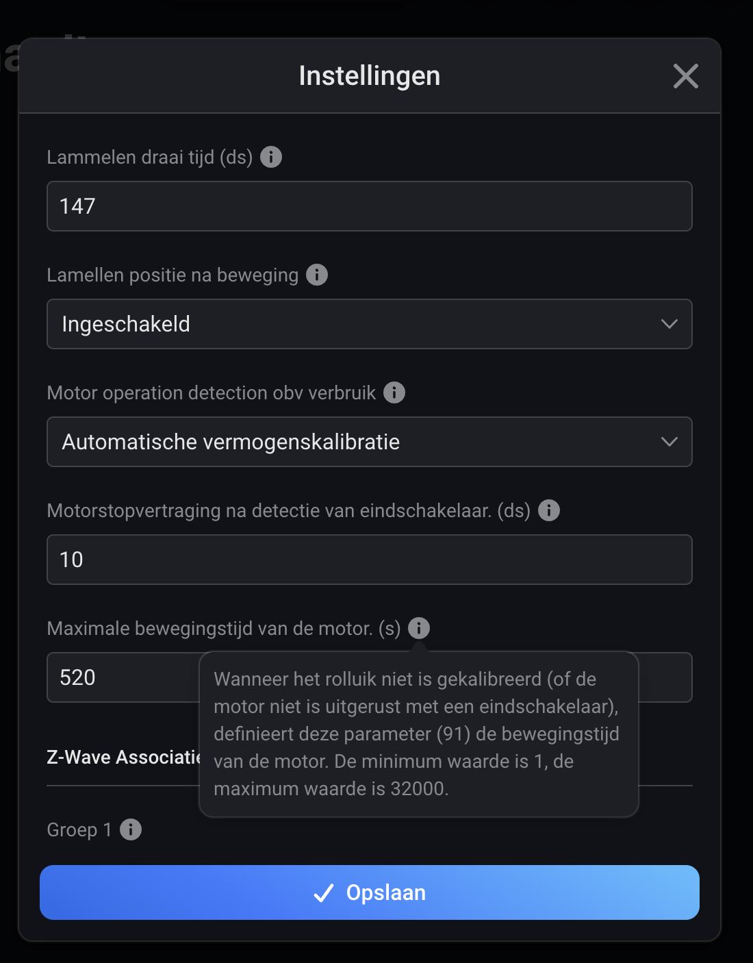

I’m configuring and calibrating my new Shelly Wave Shutters together with the ā€œdumb motorā€ screens we’ve bought. So far so good.
When clicking the ā€œcompletely closeā€ button in the Homey interface, the screen only goes down for 5.2 seconds. My guess is that this is related to the setting as shown in the screenshot attached.
The description states the value is in seconds, but I think this value is in deca-seconds (1/10th of a second)?
Not according to the Shelly knowledge base: Wave Shutter (EU)
It’s weird though that all time-related parameters get an argument in 1/100th of a second, but not this one.
Yeah. I checked a spreadsheet with parameters that I was given by Allterco Robotics and it says seconds as well. But I’ll ask them.

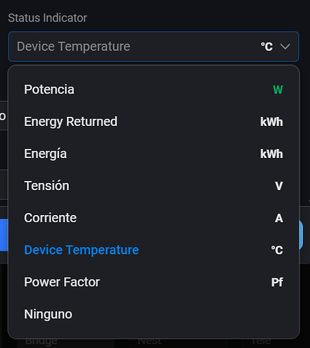

Hi! Is there any way to see the position of the roller shutter/blind here?
Does not appear in the ā€˜Status Indicator’ dropdown
