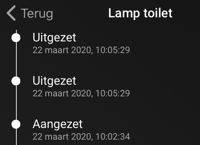

I have a Shelly Dimmer (normal, no SL) to switch the toilet lights. When I switch it on/off with the existing light switch it makes 2 identical entries for each action in the timeline. See below. Switching the light from within Homey, results in only 1 entry (as it should)

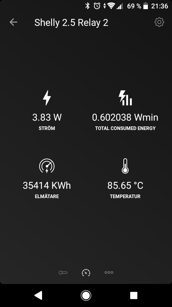

The measurements are rather confusing. I’ve got a couple of Shelly 2.5 and the only thing that is fully accurate in Insigths is the temperature, the rest is a hodgepodge of incorrect labels, mixed up measurements and possibly incorrect translation to Swedish. As I see similar issues with other devices I’m fairly sure some, if not most, of the errors are out of the scope for the Shelly app, but perhaps others can pipe in on this.
From top in Insights:
First graph shows power (W) on the vertical axis, but the graph is labeled Ström (current).
Second graph, Total consumed energy, not translated to Swedish, y-axis labeled Wmin, but the values appear to be in kWh.
Third graph is called Elmätare, the y-axis is labeled kWh, but the values look more like Wmin.
Fourth graph, temperature, no issues with that.
Fifth graph, labeled Energianvändning (energy use), it’s the same as the first graph, hence Efektanvändning (power use) would technically be more accurate as the y-axis is power.
If you open the Shelly devicey in the Home app on the phone you will see momentary status of the first four.

Wow, but it’s very hot! I thought my Shelly 2.5 with 65 and 72 degrees was hot!

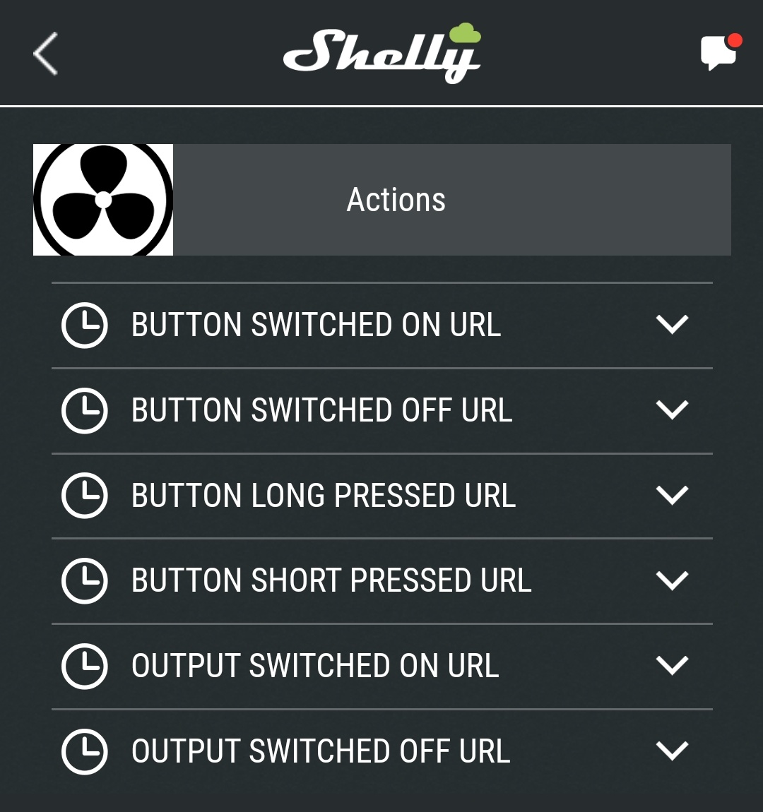

Can’t you then just use the trigger card “When Shelly 2.5 turns on”?
Otherwise…:
Or maybe through MQTT state?
