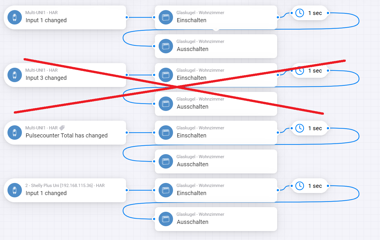

Input 3 is added under the first device. As this device has only 2 switches I had to add the third input (a digital counter input) under one of the devices created based on the switches. But seeing your screenshot you already found that out, so what is actually your question?
I thought something similar.
I have connected a proximity sensor (LJ18A3) to the counterport. This sensor is to be installed on my water meter.
The counting only works as a counter, not as Input3.
But that is not a problem, you just have to know it.
I donât know if thatâs right - but it works:
Could you post the output of http://yourshellyip/rpc/Shelly.GetStatus. Just need to check how this third input is registered under the device status. Could be I can remove the input capability for the third inpute on device 1 altogether and indeed have users use the pulsecounter trigger card for this.

unfortunately I couldnât activate/switch input 3

You cant trigger it because input 3 isnt a boolean (on/off) input. These input 3 cards are useless on the Shelly Plus Uni. I need to think about removing them or just telling people not to use them as removing them is kinda complicated and there are not many users with a pulse counter anyway.
