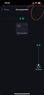

The values are okay, that’s not a problem. It’s reporting the same as it was before. I just thought of something, the solarpanel values are also measured through the same EM device on another clamp and I forgot to remove/re-pair that device/tile so maybe that caused a conflict. So I now removed and re-paired “both” devices/tiles. The first thing I notice is that the settings-icon for my solarpanel-EM-device is missing in the Energy screen which was there before.
I know from last time it wasn’t showing correct values in the Energy screen anyway until there was some measurement from the solarpanel EM so I’ll wait until tomorrow now and see if anything changes.
Update: no improvement. And now the EM device/clamp for the solarpanels is both in the smart devices section and in the solarpanels section
. I’ll get back to Athom support…
