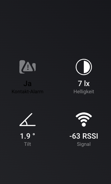

Hello
i have Problem with the Shelly BLU Door/Window Sensor.
there the door is closed
now the door is open
but i get no Information. Somebody from the German Peopel in the German forum explain the same. in Homeassistent it is working
thanks al lot
What does this mean, I see no errors. The only thing I see from the screenshots is that the state is registered correctly but there is a strange issue where the open are is hardly visible. That could be a bug in the Homey app but would be unrelated to this Shelly sensor.

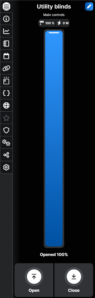

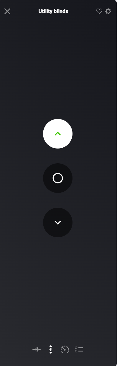

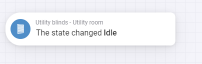

For Shelly Plus 2 PM in a cover mode detecting idle stat is not working. If I also manually set idle (O button) it shifts back to up. App version 3.27.3
native Shelly app
That’s a bit of a semantic thing. The windowcoverings_state has three states called up, down and idle. I’m currently setting the value to up when the shutters are opening but als when being fully opened. Shelly has different states for this but Homey hasnt. But setting it as up or down when it’s actually fully up or down allows you to use it as condition. Setting it to idle when it not moving either when it’s up or down or neither isnt useful in that case.
Hi Phuturist
the Blue Door Windows there is one Sensor for Tilt an a other Sensor for open or Close
for Tilt i can say is the tilt open an for the other i can say is the Door open. thats the different.
But Homey can only open and Close not the tilt
There is a tilt trigger card with the tilt value as token. You can use that as condition in a logic card.

Did you try to just send the token to a notification to see if it’s changed and what the value is?
Thank you very much for your help and support.
Hi
how can i do that?
Sorry but i am newbie in the Homey
Simply remove the and section and pass the #toke value to the notification body. That way you’ll see if the value changes at all and what that value is.
If you go under the sensor and check the tilt value, is it correct?

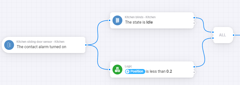

In this case, how do I know that the blinds are no longer moving?
Example flow I have with the Shelly 2.5 and it works, but with the Shelly Plus 2 PM it won’t work because the state will be down whether the blinds are moving or not (because they will be fully closed).
Even if I add, an additional condition if the state is down and the position is 0 this will not work, because if I change the position with the slider to 0, the position value is updated immediately and the blinds start closing (moving down).
If they are fully closed or open, this when trigger will not be executed.
Background: I have Venetian blinds and Shelly doesn’t currently support tilting, so I added this support by myself and that this works correctly the blinds should be in idle mode before changing to reverse movement.
Conditions for Shelly 2.5:
- Up: when is opening → moving up
- Down: when is closing → moving down
- Idle: when is not moving
Get the position of the blinds with a logic card
- 1: Fully open
- 0: Fully closed
- 0.01 - 0.99: 1 % - 99 % open
I might regret it because other users might expect the current behaviour but I’ll change it with the next release.
